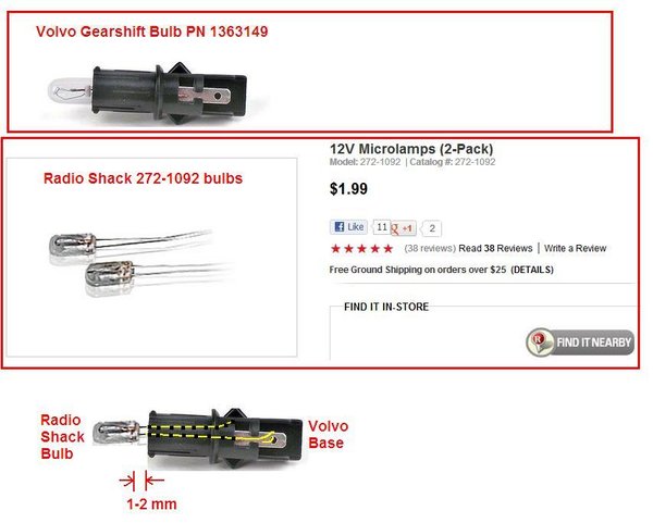

I wrote a short trick on Radio Shack bulb for 99 cents, threading it in through the 2 spade holes (after the burned bulb is removed):
More info here:
https://www.matthewsvolvosite.com/forums ... =1&t=14201
