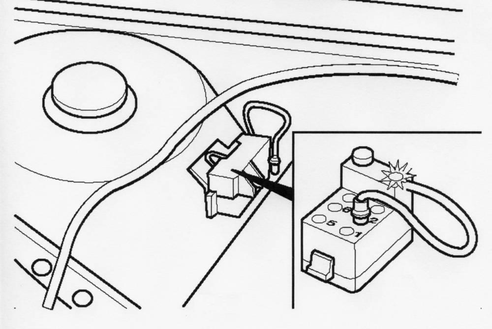

There should be a data link connector on the front nearside inner wing near the air filter.
To use it:
Accessing.
Open data link cover.
Insert system selector cable, which is stored in cover top, into socket 2.
Switch ignition on .
Press test button for 0.5 to 1 second.
Count LED flashes.

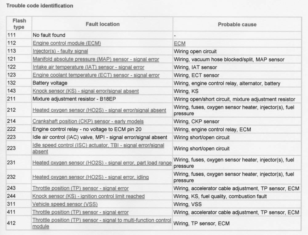

Trouble codes consist of a sequence of three groups of flashes.
A 3 second pause seperates each group.
Note trouble codes. Compare with trouble code table. For example
1 flash 3sec pause 2 flashes 3 sec 1 flash
This = a code of 121.
Trouble codes must be accessed and faults rectified before codes can be erased.
Erasing.
Open data link connector cover.
Insert system selector cable in socket 2.
Press test button for 5 seconds minimum.
Release button. Wait until LED illuminates.
Press button again for 5 seconds minimum.
Ensure trouble codes have been erased.
The ECM fault memory can also be erased by disconnecting the battery.
DTCs 440.jpg (120.68 KiB) Viewed 2634 times

460gleH628FTA
Posts: 3
Joined: 14 December 2008
Year and Model:
Location:
Post by 460gleH628FTA »
No diagnostic module fitted

Post by billofdurham »
Is there any sign that a DLC has been fitted and removed? Are there any unexplained wires lying around in the area where it should be?
Sometimes these units stop working and are removed as 'useless bits of kit'. If there are wires you should be able to pick up a DLC at a scrap yard and refit it.
