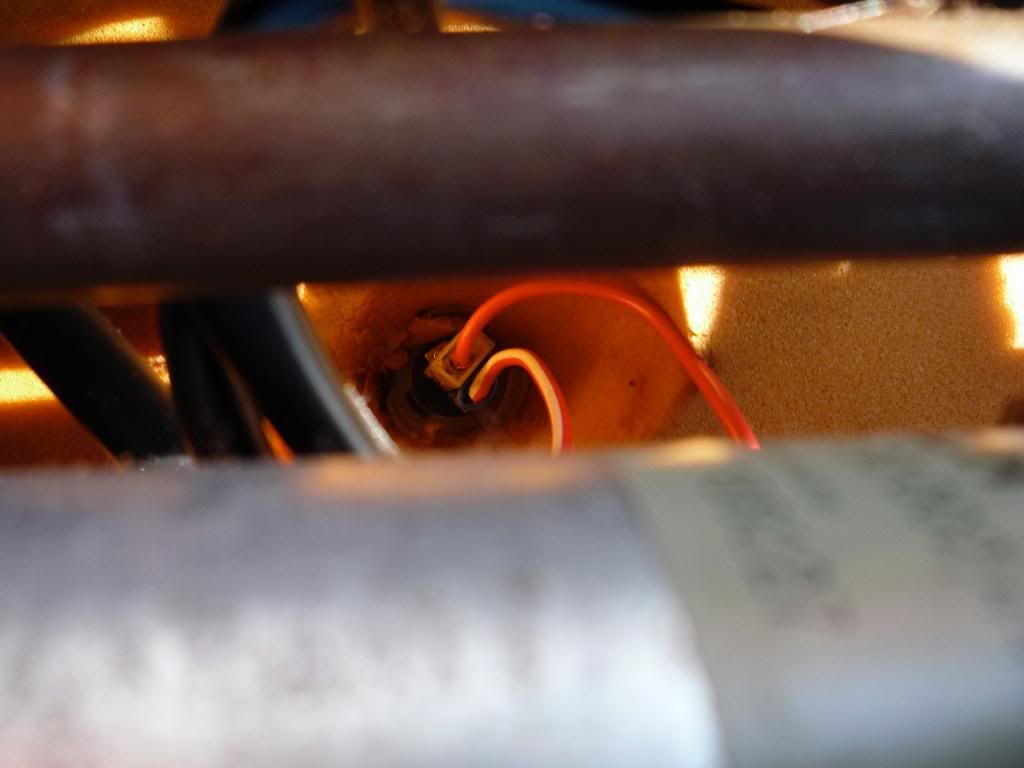

Everything was good until I tried to check the thermostat, a quick peek below the seat showed me that the wires where in fact disconnected. Not so quick slim!

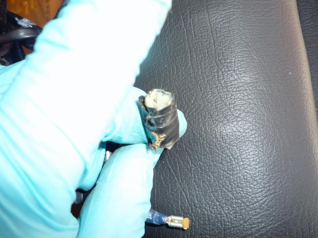

I found that the seat had been worked on before and a lousy job had been done of it. The connector came off in my hands and the pin on the thermostat had been broken off, the problem was solved.....in theory at least!
The offending item!
The piece of the pin in the connector

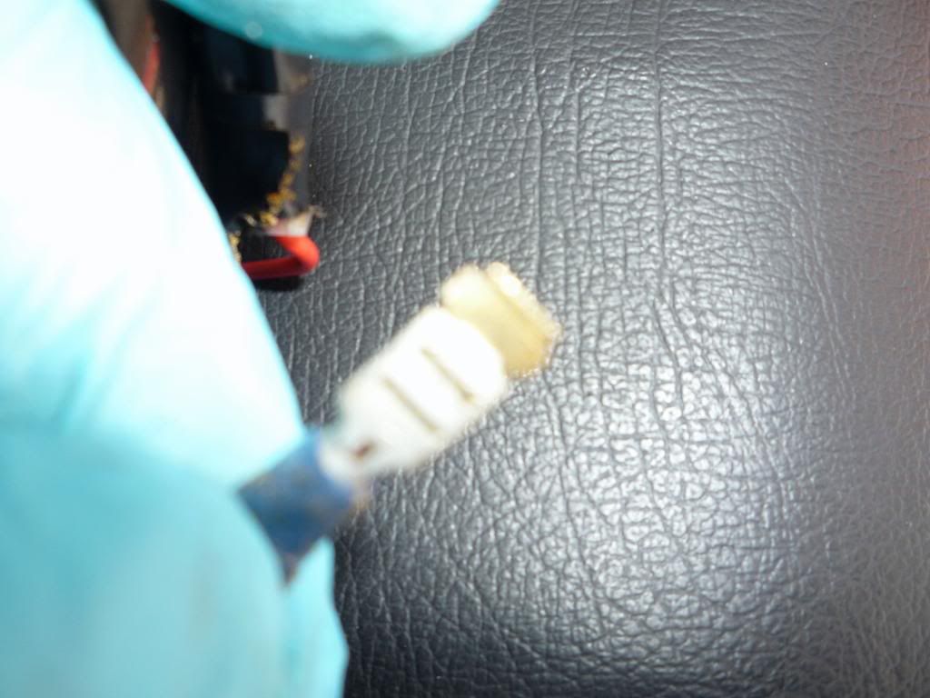

This is what the connectors looked like.
This what they should look like.

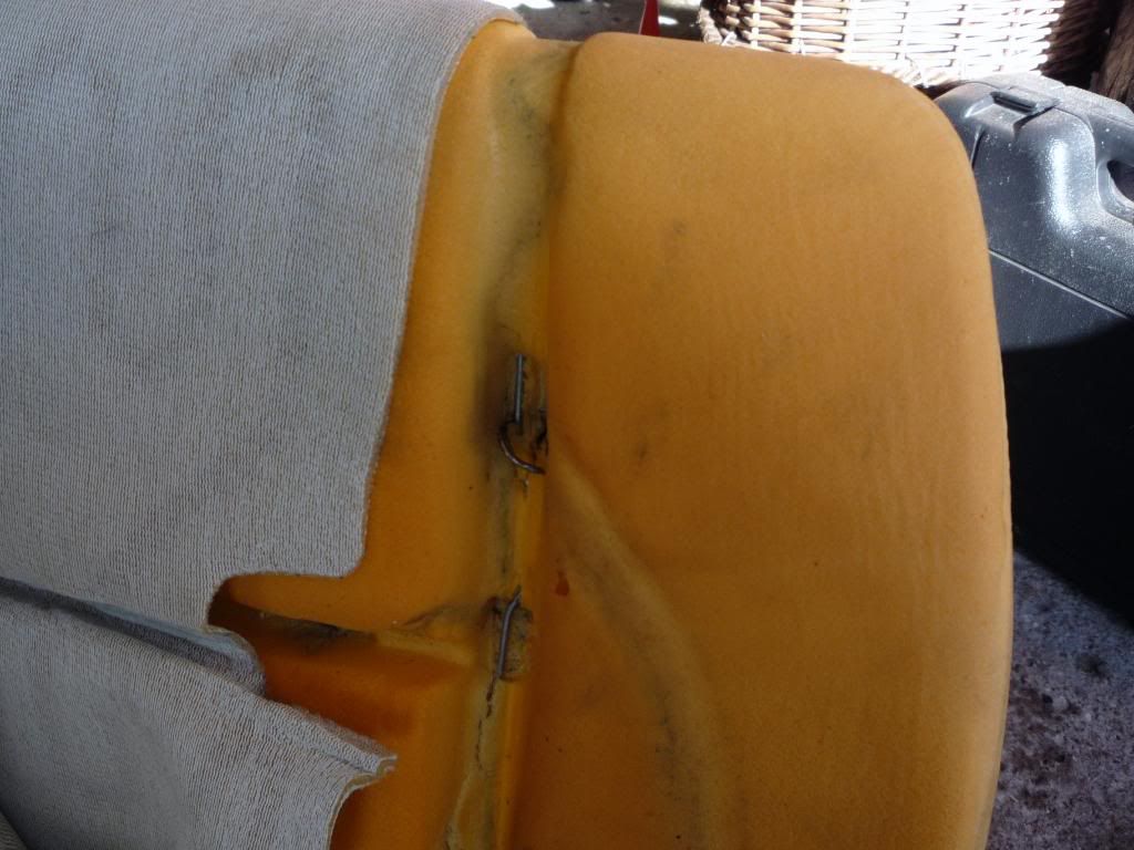

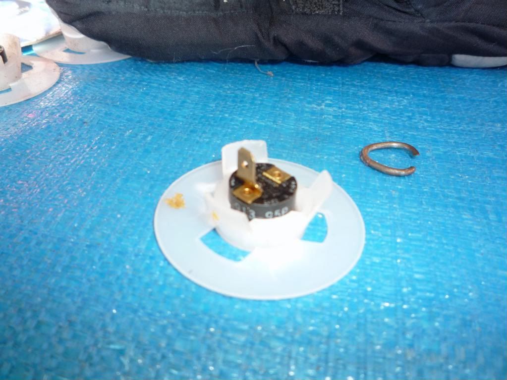

I also removed some the metal rings from the right top side of the seat cushion to allow the leather to be peeled back a little further to give me access to the thermostat. The thermostat just " drops in."
Above shows the thermostat hole from the top side of the seat.

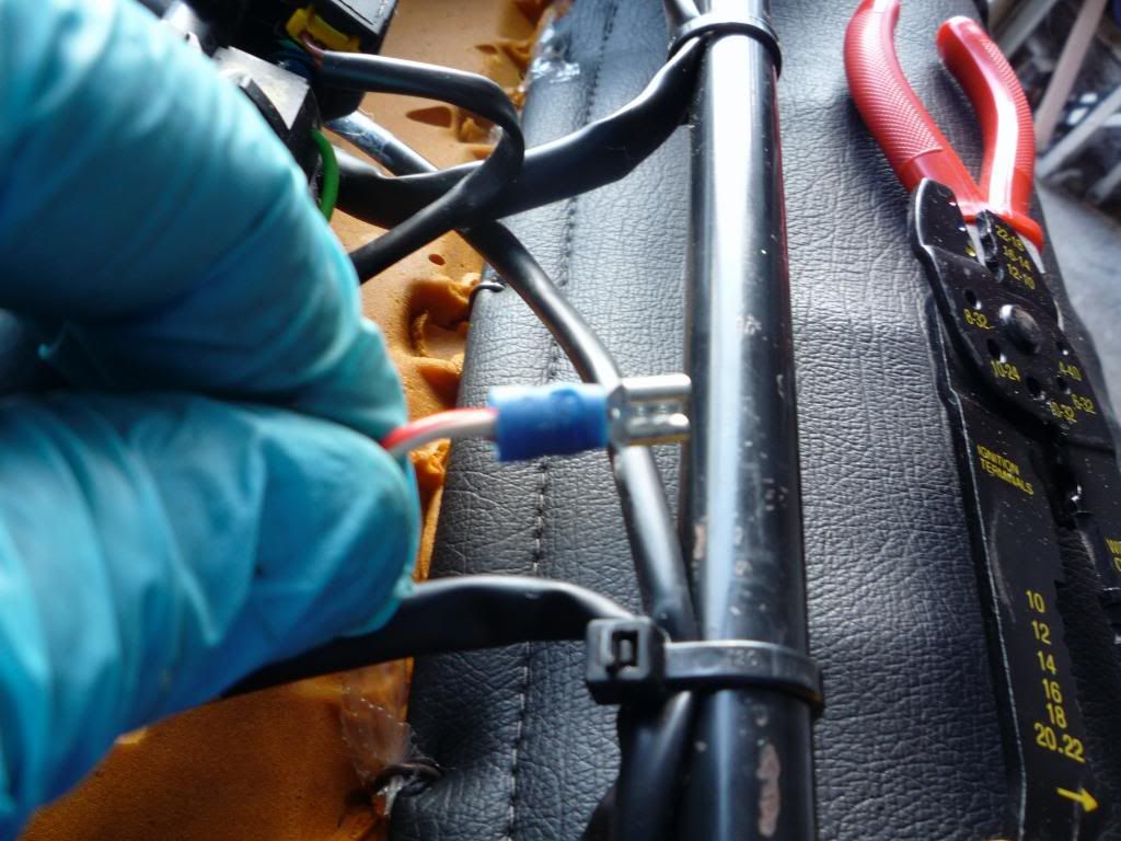

A quick re-crimp of the wire and insertion of another thermostat, I happened to get a few from the yard on my last visit, lucky for me. :mrgreen:
I pushed in the connectors, but did not do any extra tape or cable tie work, I hope that it will suffice.
