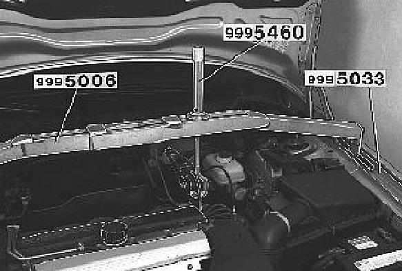

Ways to hoist your engine vary, but here's Volvo's option (pretty much just holds it up):
engine holder.jpg (59.83 KiB) Viewed 911 times
