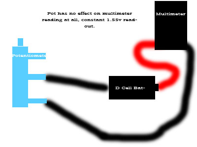

here is a hack job image of how I believe it is supposed to be hooked up. it is a 10k Ohm pot. I am trying to get the voltage to go from 1.55v to between 0.1-0.2 volts. I have checked for short circuits etc... in my mind there is no reason why this shouldn't work???
Any suggestions as to why this will not work?

Post by MadeInJapan »
I have no idea, though your diagram seems straight forward- Why didn't you get the POT that was used on V.S.? If you can't get it, why not go to radio shack an find one that will do what you want it to do? The guys there will even hook up a battery and help you test one until you get your desired results.
