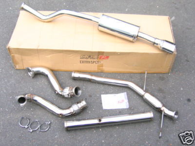

I'm looking at buying an OBX turbo back exhaust for my 855. By looking at the picture of it, it doesn't seen to have a cattalytic converter on it. Correct me if i'm wrong. And if it doesn't have one is it easy to plug one in if I bought one and took it to the guy that will be installing the exhaust?

Wow. Thanks a lot. The "newly approved by California" catalytic converters are selling for around $220. Doesn't make the exhaust such a deal anymore. Here's a pic of the exhaust.

weired that you all seem to have not so good out comes with cat backs. maybe its because making the exhaust bigger after the cat where the exhaust starts to cool and condense dosent make sense. hense why OBX goes from a 3" downpipe to 2.5. not from 2.25 stock to 2.5. cant make power with the huge factory cat.

OBX is stainless steel. and $415 shipped. best bang bor the buck period. just no cat, not a problem in my area.
