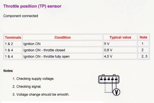

4-1-1 is Throttle Position Sensor (TPS) signal error. Possible causes are wiring fault; accelerator cable adjustment; faulty TPS or ECM fault.
Check the wiring to the TPS then, with a voltmeter, check for voltage at the plug.
Values should be as in the attached.
TPSensor check.jpg (18.8 KiB) Viewed 6295 times

Finally, I managed to measure my TPS and here is the result:
Supply voltage:5.05 V
Throttle Closed:0.83V
Throttle fully open: 3.05V
So this means my TPS needs to be changed? :shock:

The supply voltage and throttle closed are near enough but the throttle open is well out of spec which would suggest a TPS is needed.
