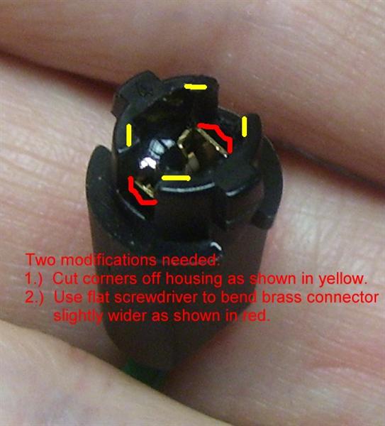

The three bulbs in the climate control unit of my '94 855 all failed over this winter season. I had a chance to pull the unit out today, and took the bulbs in to the local auto parts store. They did not have an exact match, but did have a similar bulb, GE #74/BP2. These bulbs are rated at 14V 1.4 Watts, the same as the original, but are just slight larger in diameter and socket length (about .025" larger in each of those dimensions). The socket width is the same as the original.
With some very minor tweaking they pop right into place, and work just fine. Here's the quick and dirty repair sequence:

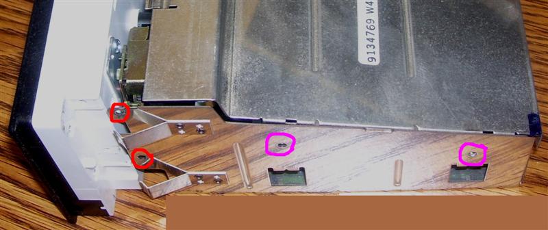

3.) Using Philips screwdriver, pull the four screws on each side of the climate control unit, and remove cover. See pic below with screw locations circled.

5.) Pull the bulbs from the sockets, and modify the sockets as shown below.
6.) Put in the new bulbs, and reassemble!

- Screw locations to remove cover and front panel.
- 1 (Medium).jpg (42.46 KiB) Viewed 12088 times
- Socket modification details.
- 101_1403 (Medium).JPG (36.92 KiB) Viewed 12073 times
