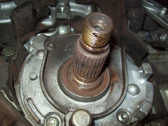

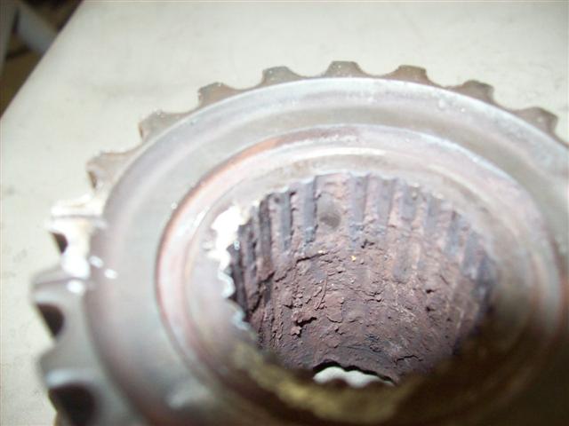

Hi to all after six weeks in the shop the dealer finally found the cause of the hard starting and running rough, and it was not the ecm; nor was it any of the many sensors they tried. The cause was the timing belt sprocket on the crank shaft had wear on the inside of the sprocket were the crank and sprocket come together allowing play. This was only discovered after the dealer resorted to calling in a specialist from corp. After looking at there info he instructed them to look for this. This was hard to find because every time they would look at the timing mark on the sprocket everything lined up. The specialist said that he had only seen this on one other vehicle. The worn sprocket was sent to Volvo corp. for examination. If anyone is having a similar problem have this checked. I am including the pictures so you know what to look for.

bshinn, I agree with your assessment of the crank, it does not look good.
marsphoenix24 is Volvo going to warrent the crank, or at least meet you half way? I sure hope so, but with Volvo's poor support on ABS and ETS issues, I wouldn't have much hope.
To other members: If marsphoenix24 has to install a new gear on this crank, what would be the recommendation? Install with JB weld, a loctite product,?????
