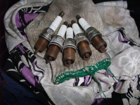

Here is pictures of plugs from my car.
hope it will help if i need to get it replace or not.

The pictures aren't very good resolution, but from what I can see the spark plugs look OK. Why did you take out the fuel injectors?
Does the missing only occur when the engine is cold?
