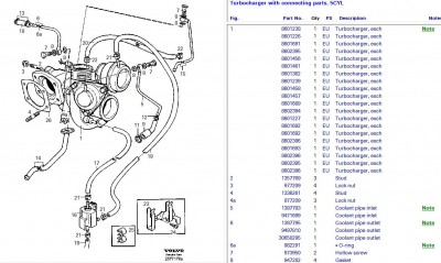

Do you happen to have a diagram in Vadis or some other source to where all the vacuum lines come from and hook up to the turbo. That camshaft seal fixed 1 leak but I'm getting a large amount of oil in the intake of my turbo. After the turbo rebuild I might have hooked the wrong hose/tube to the wrong fitting. My daughters need this car ASAP to get back to school 5 hours away. This is a big leak because it's getting past the hose clamp of the intake on the turbo and dripping down onto the tranny and making a mess on the underside of the car, all the way back to the rear bumper.
THX
Tri
THX
Tri

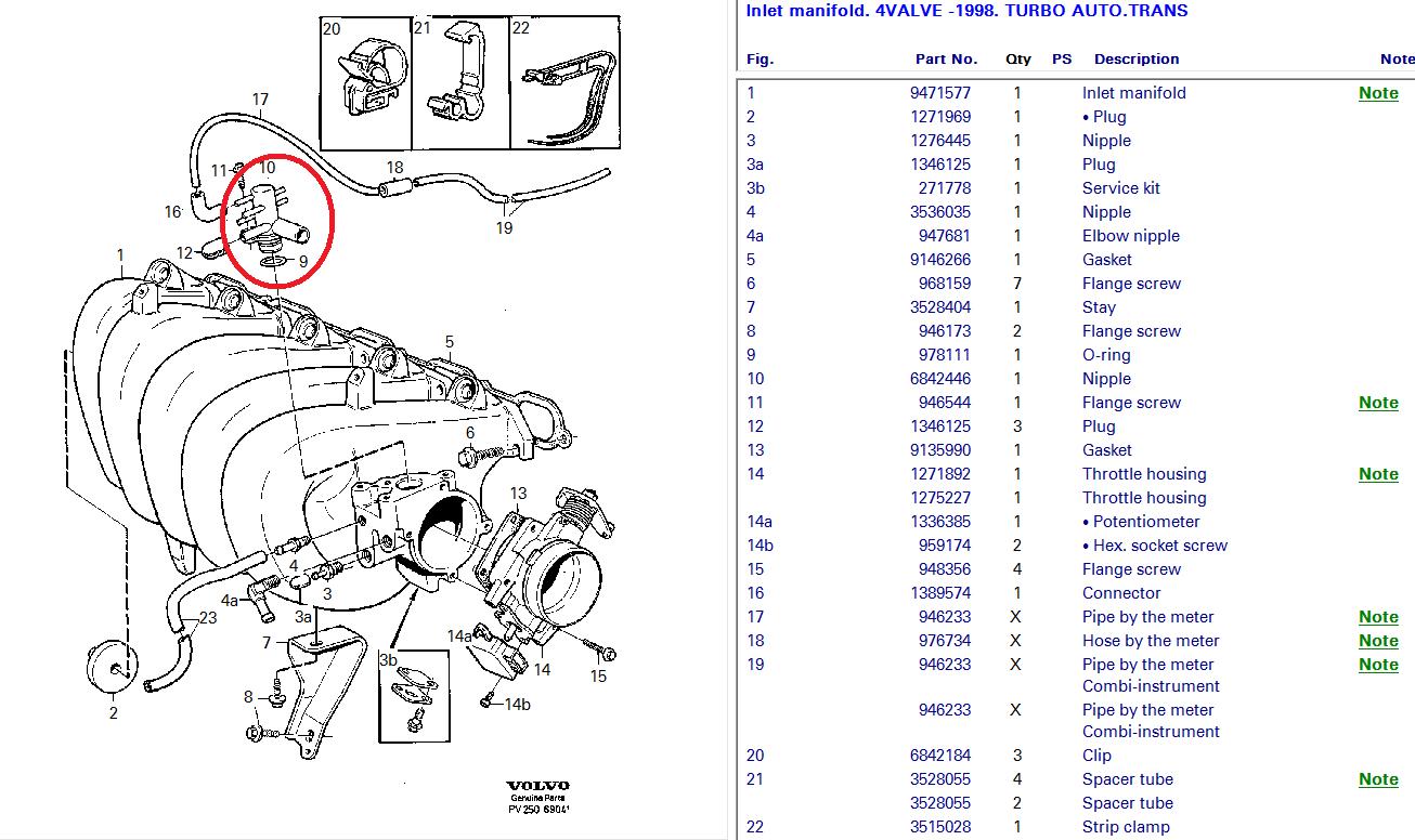

Thanks Vegas, you wouldn't happen to have another diagram showing where hose #20 hooks into. It's the only one that is unaccounted for. Your diagram showed me that I had hoses 17 and 19 hooked up incorrectly.
Tri

Unfortunately the diagrams that I have don't show both ends of everything. I think that the triangular item on the back of the turbocharger that hose #20 is hooked to is the Compressor Bypass Valve that directs compressed air from the output side of the compressor wheel back to the input side when you're under boost and let off the gas. This is to prevent a pressure shock to the compressor blades. If so, then I think that hose #20 should be connected to the vacuum tree on the intake manifold, shown circled in red in the diagram below:Trilarry wrote:Thanks Vegas, you wouldn't happen to have another diagram showing where hose #20 hooks into. It's the only one that is unaccounted for. Your diagram showed me that I had hoses 17 and 19 hooked up incorrectly.
