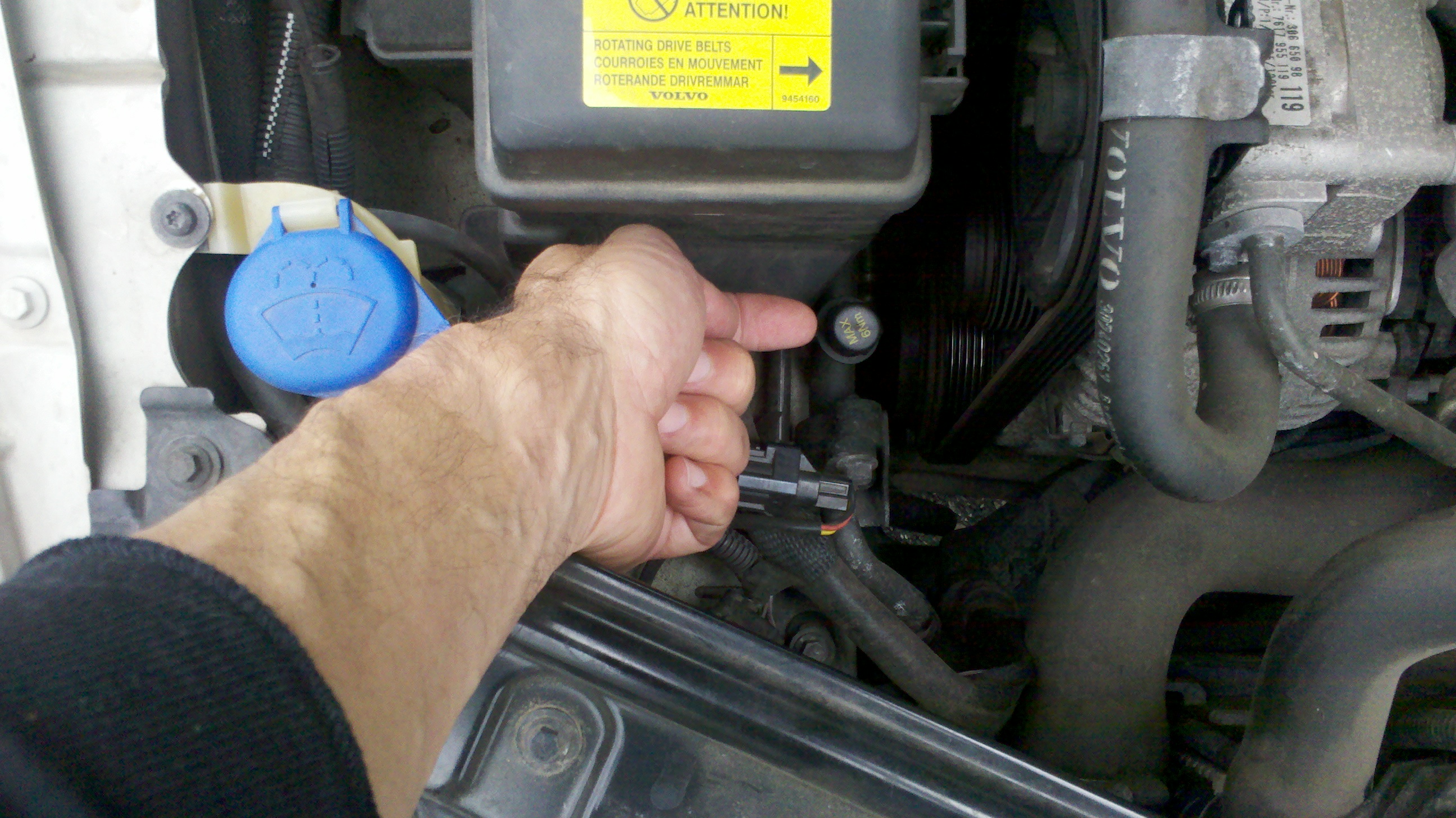

I disagree vehemently with those that say that you can not refill the R134a Refrigerant on the S80. I just refilled my 2006 Volvo S80, and it was incredibly easy. You don't need to find the High Port; use the Low Port, instead. I used: A/C Pro for my vehicle. $39.95 retail. (Note: I am not a shill for A/C Pro; I just happened to use their product, and found the instructions and complete procedure to be incredibly easy.)
I attached the quick-connect fitting to the low port valve. The initial pressure reading was about 10 psi--taken with the engine running. I pulled on the trigger assembly, to initiate the charging process (after following the instructions on the can) and it started to charge, or refill my system. I consistently turned the can to the 3 o'clock, and 12 o'clock position and released the trigger intermittently to check the pressure. Once it reached about 32-35 PSI, I stopped the process.
On my '06 S80, the Low Port is located about 10-12" (25-30cm) behind the passenger headlamp assembly. It is mere inches from the exposed drive belt, so you want to ensure that you remove the valve cap, prior to starting the engine, for safety reasons. (I have attached a picture; my left index finger is pointing to the valve cap.) [Side Note: I have looked at some forums which indicate that the location of the low pressure port is under the P/Steering unit, towards the back of the engine compartment, and several parts have to be moved to achieve this. I would not have accomplished this with my mechanical aptitude, had that been the case.]
