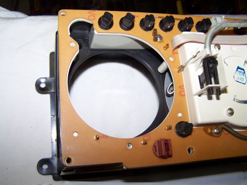

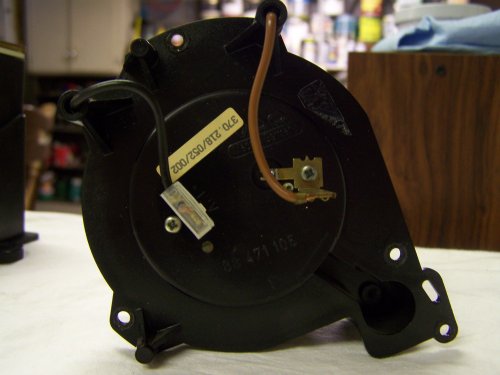

I only see 2 wires. The black one shown says 12 volts at the base on the plastic. The brown one seems to be a ground. I saw on the diagram in my Haynes manual that there should be a 3rd wire that is red but I can't locate it. Please take a look at these pics and see if you can tell where the third wire would go.
Thanks,
Bill

Of course it is going to confuse things even further as this is the Volvo diagram and it shows black, red and green. Black is earth (ground), red is power from fuse #8 via the circular connector contact #9 and green is from the rheostat via the circular connector contact #10.
Your clock doesn't show any lights attached to it so is it possible that it receives light from one of the bulbs in the panel? If so it wouldn't have a separate green wire.
Bill.
