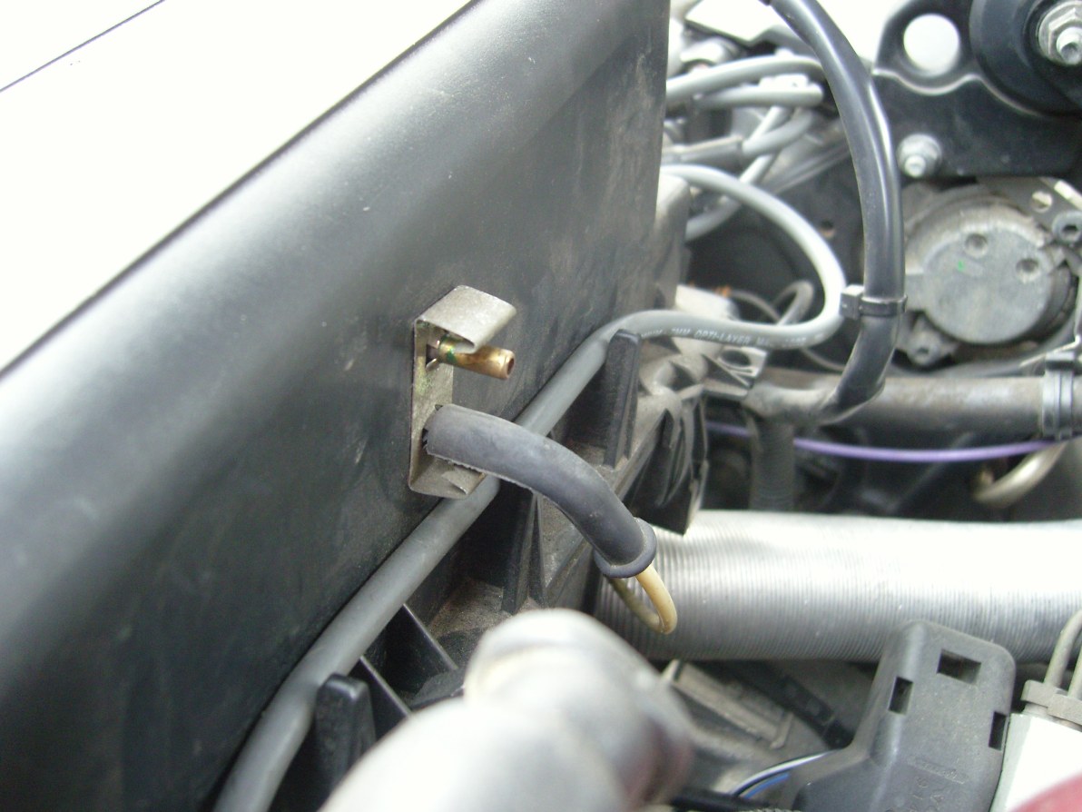

Hi, I'm new here. Just found the site a few weeks ago and it has been very helpful so far. I just replaced my upper motor mount via instructions from the site and in the process I noticed a vacuum hose was detached from the air filter box. When I tried to reattach it the other end came off from where it was attached(somewhere near the flame trap) and I can't locate where it came from. I searched around the site but could not figure it out from the other posts I found. Also my car is not a turbo. Any help would be great.

- The top nipple is where the hose came off of but I can't locate where the other end attaches.
- SNC13221.JPG (166.64 KiB) Viewed 4093 times

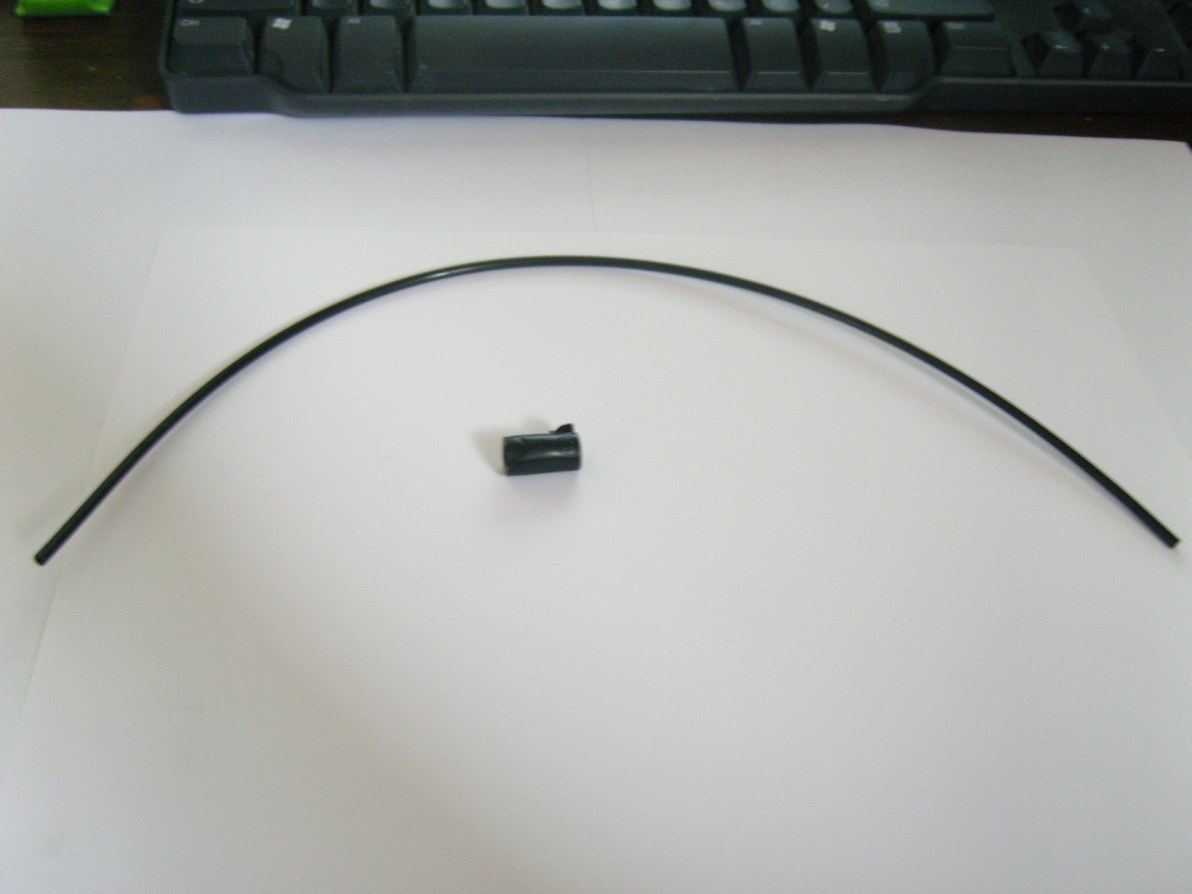

- This is the hose that came off and the connector which needs to be replaced.
- SNC13227.JPG (110.96 KiB) Viewed 4093 times

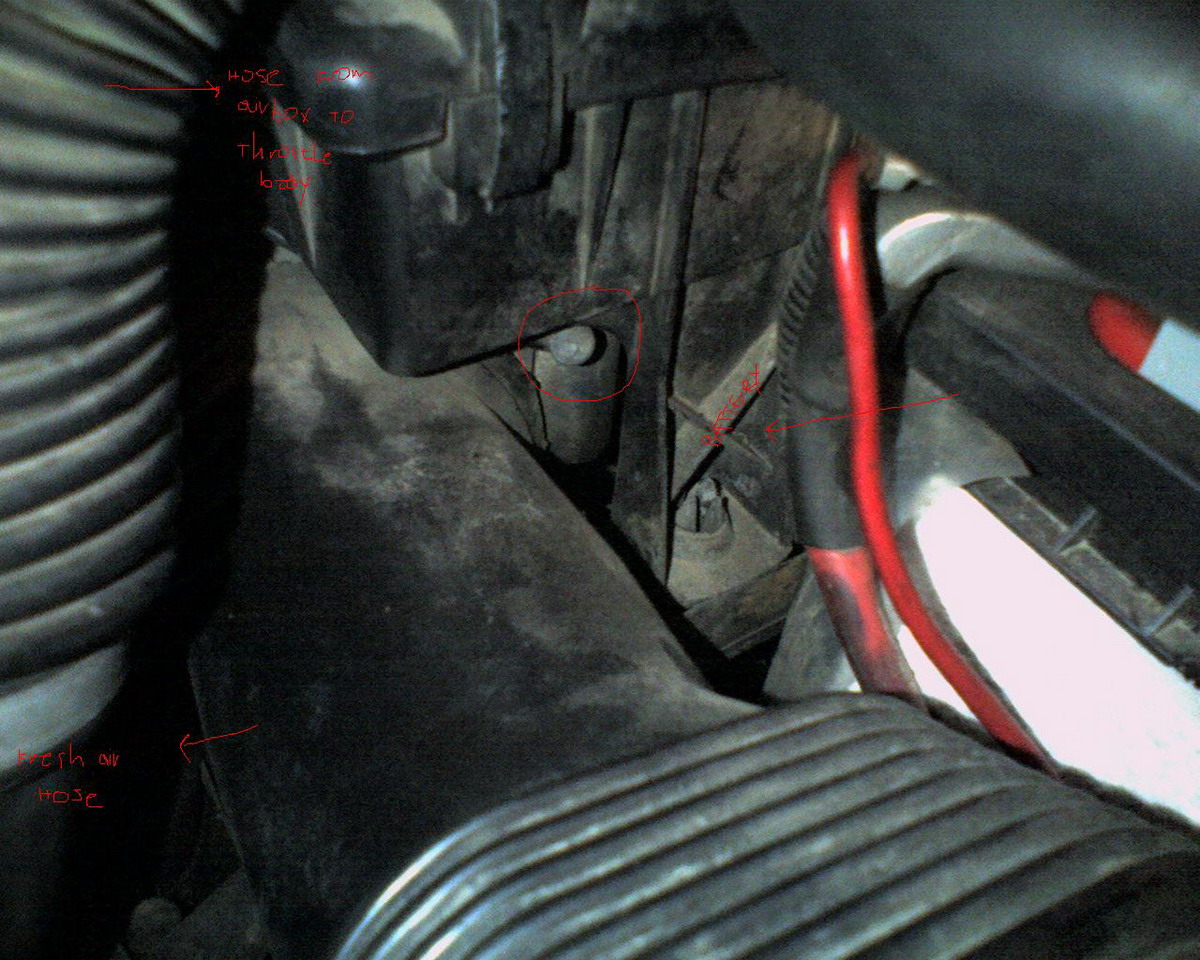

- misha
- Posts: 5437
- Joined: 07 Dec 2008, 16:09
- Location: Serbia
- Has thanked: 155 times
- Been thanked: 432 times

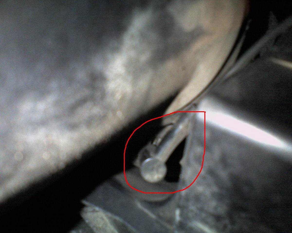

As i can see it's a black vacuum hose and it's connected at opposite lower side of air box housing.But if i remember well,there is no rubber elbow at that side,like at top behind.The lower side connection is more like some kind of clip(which looks like some kind of elbow),but not rubber.
If you need picture i'll post you tommorow.

A picture would be great Misha. I've been looking around for about a day or so with no results. thanks
- misha
- Posts: 5437
- Location: Serbia
Here are the pictures:
- Photo-0187..jpg (239.2 KiB) Viewed 4038 times
- Photo-0191...jpg (319.79 KiB) Viewed 4038 times

Pinned in the repair database. This has come up many times with no real good answers.
Thank you Misha.
