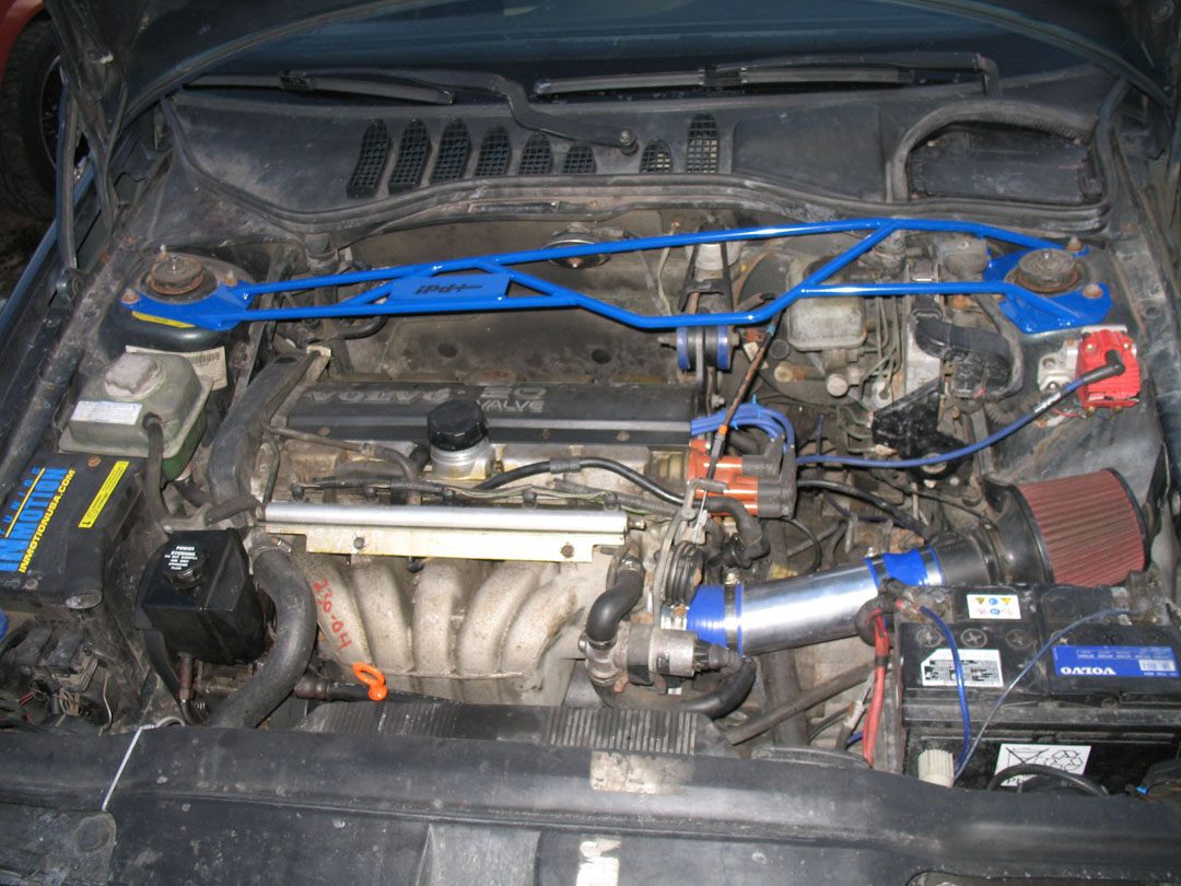

they mean by direct ignition individual coils(5) ontop of the plugs, wich you most likely wont have if its a non turbo. if you have a coil and a wire coming from behind the air box then its not direct ignition. there would also be no wires and no cap and rotor with direct ignition. post a pick of the engin bay and its wasy to tell the diffirence. above the airfilter on the drivers side you can see the Red coil. non direct ignition. and of course all the wires in blue.Vernh59 wrote:I am trying to order a tune up kit for my 99 S70 n/a and then I see the note "for ......without direct ignition." I have an engine code of B5254S is this engine direct ignition? How do you know by the VIN or engine code? I have searched the forum and I find many references to the engine code but not for the ignition.
