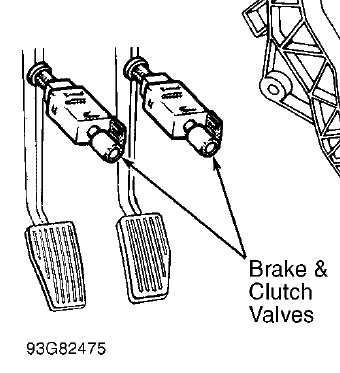

Check the switch right above the break pedal. I had the exact same problem with the not enough speed code. There's a switch above the brake that comes out and the break presses on it. Basically you have to adjust the switch. There's a slider thing in the switch, pull that out so that it is always making contact with the brakes.
If you need more help, I can post a diagram if you'd like
Ah i'll just upload it. THere's a switch/valve for the clutch and a switch for the brake. So, if you have an automatic, you obviously won't have a clutch. But here's what it says in the manual.
"Brake & Clutch Valves
Valves are self-adjusting. If Manual adjustment is desired, depress pedal until pedal arm does not make contact with the valve. Pull out plunger (on the valve) as far as possible and release pedal slowly. Plastic catches in the valves will hold piston in correct position."
I'm 90% sure this is your problem. I had this exact problem and readjusting my valve/switch fixed it. Be careful not to pull up on your brakes though, or you'll have to do this again.
