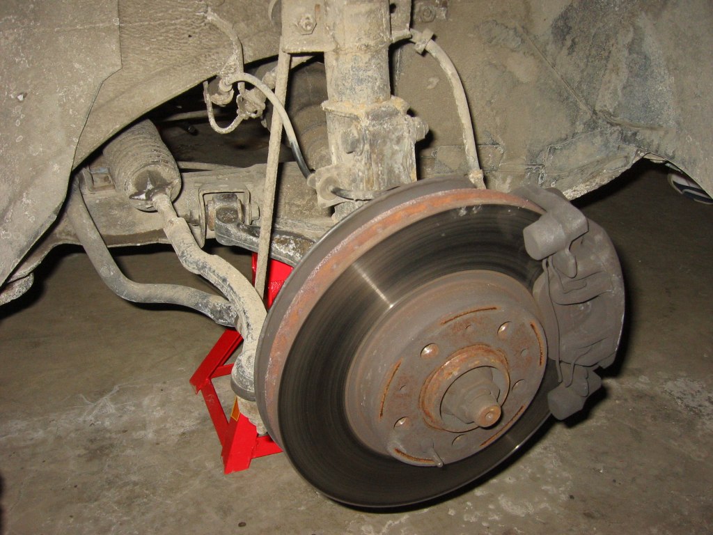

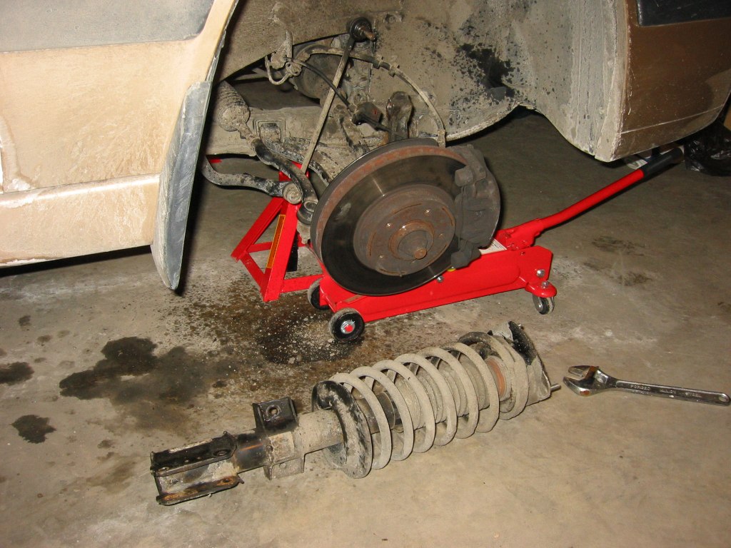

First, jack the front up and support it on jack stands (1 on each side).  The jack stands are positioned on the sub frame of the Volvo (check your manual to see where it is safe to put jacks under the car).  The sub frame runs around the front end of the car.  Block the rear wheels and remove the front wheels.

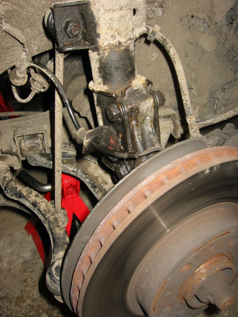

Use your WD-40 or Liquid Wrench and spray on the 2 strut-to-steering-knuckle-nuts, ABS bracket screws and Sway Bar connecting link.  They are commonly rusted and you will need to spray lots and be patient when taking these nuts out.  Be really, really patient....

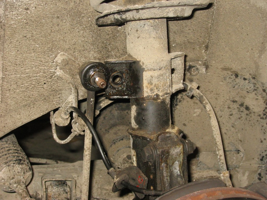

There is supposed to be a Torx hole that you can hold on to in the front of the sway bar link nut and undo the nut.  But sometimes the hole is rusted and cannot be used.  You can reach behind the nut and use a wrench to hold onto sway bar link bolt to undo the nut.  This is the part that took 40% of my total time because it was so hard to grab onto and so rusted.<br /><br />What you see in this picture is the sway bar link bolt, look closely, you see that its not a complete circle behind the bolt.  That's where you grab with a wrench.

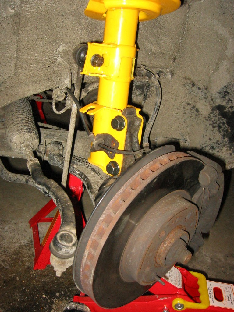

Use the floor jack the support the suspension by jacking up the A-arm.<br /><br />Undo the bottom 2 strut-to-steering-knuckle-nuts and the 3 nuts holding the strut in place inside the engine compartment.  It is also a good idea to break the Strut mounting nut (the big one in the middle of the strut) free before you take the strut off the car. <br /><br />Updated: It was suggested that using a torque wrench as a breaker bar is not a good idea if you like to keep your torque wrench accurate and serviceable for a long time.<br /><br />Once you have all the nuts off, maneuver the strut out from the bottom (be careful NOT to break the ABS cable, it will get in the way and you're better off to have help from someone.)  The strut assembly is quite heavy (about 30 lbs) but if I can do it myself, so can you.

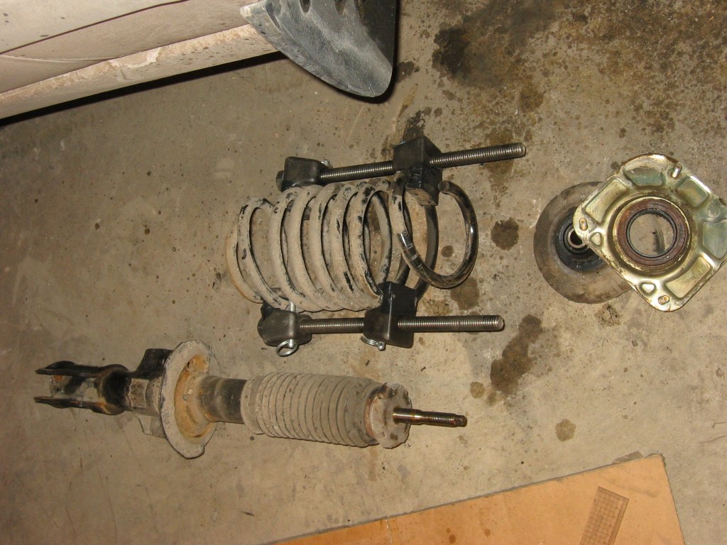

Do NOT unscrew the top retaining nut or the cross shaped retaining nut.  Or else, the spring will fly right out and cause some serious damage.  Mount the spring compressor according to its instructions and compress the spring.  For spring compressors like the ones shown, put them 180 degrees across and turn both sides evenly.  Compress until the spring can wiggle between the spring seat and the bottom of the strut.

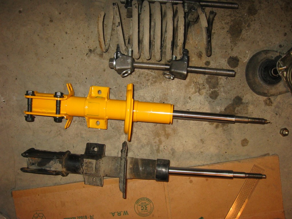

Mark the spring so you won't put them back in upside down. <br /><br />Once you can wiggle the spring, it is now safe to undo the strut retaining nut, take out the special washer, undo the cross shaped retaining nut with a pipe wrench, and take out the strut bearing mount and spring seat. <br /><br />The manual said inspect for damage and replace as needed.  But I say, if your car have more than 60000 miles, just replace them, they're gonna die soon anyway.  Also the dust boot and cap might be cracked, replace those if you need to.  Mine are fine, so I just reused them.
Compress the spring to 11.81 inches long from top to bottom (this is for a Volvo 850, refer to your own manual to see your specs) and put it on your new strut. <br /><br />I replaced mine with Koni Sports Adjustable Struts.  I can tell you they're firm and comfortable, and being adjustable is just so much fun!<br /><br />Put back the spring seat, the cross shaped retaining nut (to 50 ft/lbs, or just as tight as you can with your pipe wrench, you don't want this to fall off)  Put in the strut bearing mount and the washer, then put on the strut retaining nut (buy a new one) and tighten to 50 ft/lbs with your torque wrench.

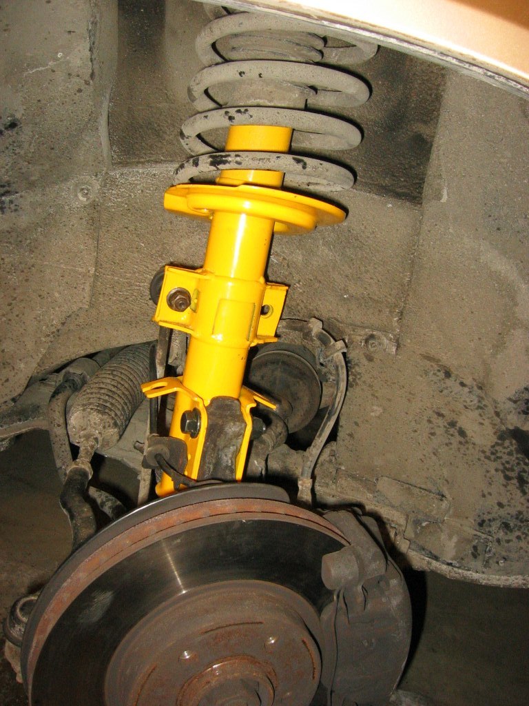

Make sure your spring isn't upside down.  Make sure the spring is sitting in the grove at the bottom and seated properly in the spring seat.  When everything is in place, start uncompressing the spring.
Maneuver the strut back into where is belongs from under the wheel well. (is it just me or is the rust growing on the brake disc?  It took me so long to get to this part!)  Put in the lower retaining nuts and bolts (use new ones) and tighten the sway bar link nut (pain in the a$$).  Don't forget the ABS cable.
Jack the suspension up and tighten the 3 upper mounting nuts (21 ft/lbs) to secure the suspension in place.  Use new nuts for that too.  When you're done it should look like this and everything should be secured in place.  Hopefully....<br /><br />You're all DONE!! YAY!  Except that you have 1 more side to do you're all done!  Hehe.<br /><br />Take a short drive after you're ALL done.  Drive around the block to see if there is anything wrong.  Remember to take the car in for alignment as soon as possible.  You HAVE to do this because the alignment is now wrong.  Don't forget about this!<br /><br />Now you can go brag about this to your friends and tell them &quot;I changed the struts on my car, piece of cake!&quot;  Don't forget to return whatever you have rented!
