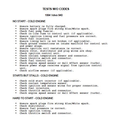

Here are some things to check when you have problems with a cold engine.
It is recommended that a check for fault codes is done first as some of the above may be superfluous if codes are found.

Spraying carb cleaner or just plain water onto the inlet manifold will help find any intake leak.
Some of the symptoms in your last post would lead me to suspect a problem with the in-tank pump. If the in-tank pump is inoperative, you'll have fuel starvation symptoms. These may include hard starting, louder than normal main fuel pump noise and a loss of power under load. To check the operation of the pre-pump without removing it from the tank, locate the pre-pump fuse, #11. Remove this fuse with the car idling. You should be able to detect increased noise from the main pump and decreased vibration of the fuel tank itself. Another way to check that the in-tank pump is working is to remove the filler cap and have someone switch on the ignition while you listen for the pump to kick in.
Bill.
