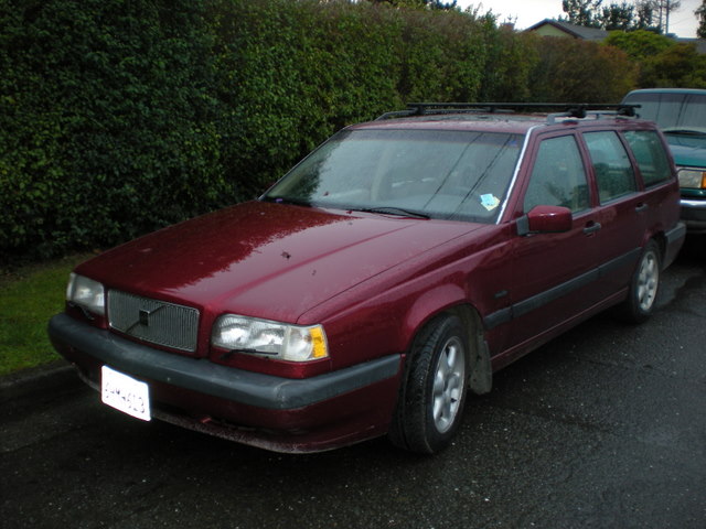

Dear community,
I have got my new 94 850 up on its legs again after a few fixes. It has an exhaust leak at the down pipe, where their is some metal wire heat shield sleeve. The top end of the sleeve has separated from the downpipe and I feel the exhaust leaking here. I noticed that underneath is a metal pipe, wavy. There is some play between the exhaust end and the manifold in the joint.
