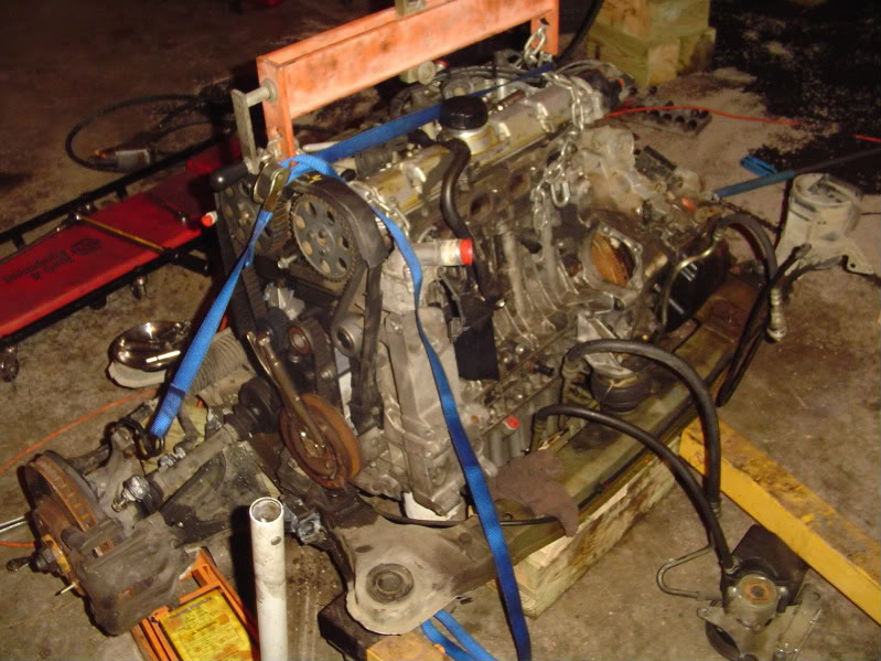

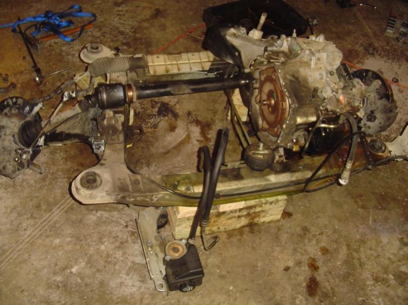

I've been working pretty steady on the car since this past Friday, in an attempt to have the Volvo up and running for a trip to see the family (3 hrs away) for Christmas, nothing like waiting until the last minute, huh? I don't want to drive my Jeep that distance, but I've pretty much figured out I'm not going to have a choice.
I've actually got a lot done for a fella working by himself with minimum tools, already made a trip to Sears, Harbor Freight, and Tractor Supply to remedy the areas I was lacking in as I've gone along.
So here's where I'm at:

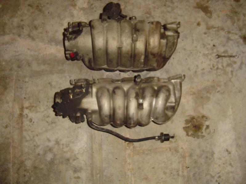

And here's where I've hit my first real snag, and my reason for Consulting my new imaginary, internet, Volvo Guru buddies :D.
So if you recall, my car is a '95 with out an air pump, and I purchased a '94 engine, with an air pump. No biggie as discussed earlier I will just plug the hole in the head.
I removed the intake to make it easier to put the new motor in the car, and was just going to swap my original intake onto the new to me motor but found out that this isn't going to work.

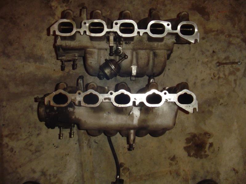

The '94 intake and head have larger square ports and runners, while the '95 intake and head have smaller "kidney" shaped ports and runners. The bolt holes line up with the '95 intake on the '94 motor, but the ports on the '95 intake are too small to completely cover/seal the '94 head's intake ports. Sigh...

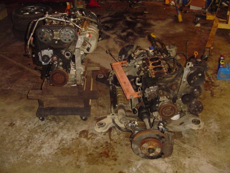

Here's a picture, '94 on top '95 on bottom:
Lola 3.jpg (57.4 KiB) Viewed 5246 times
So there's another "issue," the '94 intake manifold has some kind of vacuum actuated valve that changes the size of the intake runners (you can clearly see the mechanism and the valves/shutters in the picture above). I haven't a clue what this is, but I am assuming it will be fine to just leave the vacuum line off of it and let it stay in the default open position that the springs keep it in without vacuum. Am I correct here?
My next issue, still with the intake manifolds, is that the '95 intake has a threaded port for a hose and some kind of sensor, MAP maybe?, coming off of the bottom, and the '94 intake has no provision for this. I guess I'm going to have to drill and tap somewhere on the '94 manifold to be able to use this sensor.

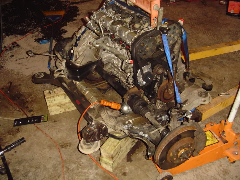

Here's a picture of the bottom of the manifolds, '94 still on top, and '95 on bottom. You can clearly see the hose and sensor I'm talking about coming off of the '95 manifold.
Lola 4.jpg (49.36 KiB) Viewed 5246 times
So other than that one sensor, I think that I can just swap throttle bodies, and associated sensors between manifolds, so the only issues I've come across so far are those mentioned above. I really never expected there to be this big of a difference between model years of motors. Though I would guess, that having the larger intake runners and ports would make a little more power than the smaller ones; so having the ’94 motor might give me a little more pep than the original ’95 motor did.

The way to handle this is to swap the block out between the manifolds, use the old intake and exhaust manifolds and keep all of the crap that came with them. That keeps your ECU happy since there are so many variations on the emissions stuff.
I normally don't see the baffles on the intake manifold unless it is a '93 or a very early '94 engine. Check the part number on the timing belt and measure its width. You may have essentially a '93 engine engine design which is OK so long as you change the timing belt exchange interval to 50k miles rather than 70k.

I meant to address this in my previous post. I can't just swap my original intake onto my "new" engine. While the bolt holes do line up, the intake ports/runners are completely different on the two motors. The original intake manifold's runners are physically too small to completely cover the intake ports on the new motor's head.
I believe I can swap throttle bodies and associated bells/whistles between manifolds and use the manifold that came with the new motor. However this will require me drilling and taping a hole for what ever that sensor/hose is mentioned in the original post.

Ozark Lee, could you fill me in a bit on this "baffle" in the intake? I assume it has something to do with emissions control? Could/should I remove it? It defaults in the "open" position, so my first inclination was to just leave it as is with no vacuum line running to it.
My understanding is that the baffles basically tuned the engine for low RPM torque and then they opened up for top RPM speed. I have personally never messed with one but the folks that have had such a system have reportedly done OK with the system just jammed to the full open position - most of them have died in that position anyway and it should cause no emissions problems. Both manifolds look like they are set up for EGR.

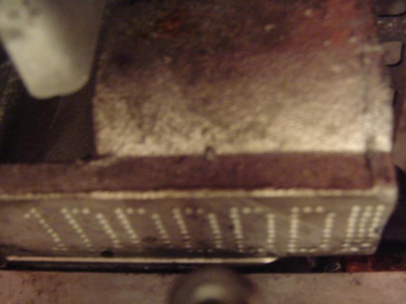

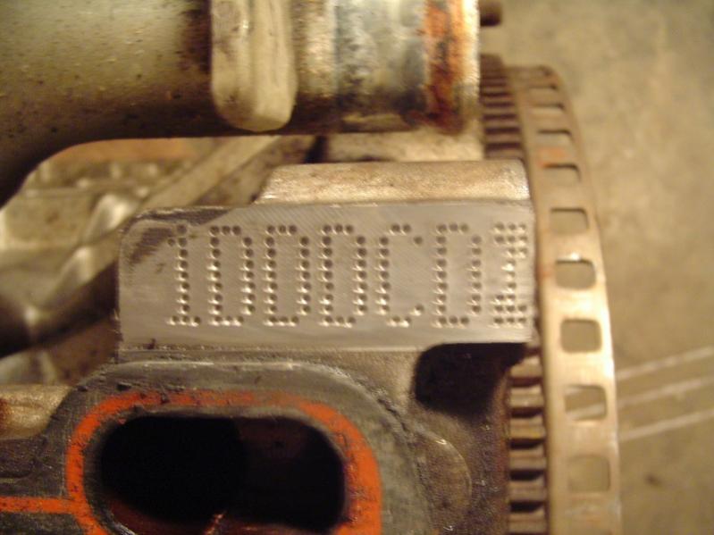

Check the actual engine serial number that is stamped on the block above the number one cylinder on the exhaust side of the block. The number on the timing belt cover might have been changed along with a previous engine swap and it may or may not match the actual block number.
From the subframe picture the inner C/V joint looks trashed on the passenger's side. The boot is completely gone.

I think these are the numbers/letters/hieroglyphs you were asking about Ozark Lee:
This is the "new" '94 motor. Still has its head and one of the studs was kind of in the way, but I believe it says, 1DDDDDW, now I'm just guessing at the "W" part on the end. It could be III, here's where I need the Volvo Gurus again.

The next picture is of the old '95 motor. It was much easier to take, no silly head in the way. I believe it says 1DDDCDI.
Lola 8.jpg (49.78 KiB) Viewed 5246 times
Both heads have 6326 cast into them, as if that means anything, they're obviously different.
