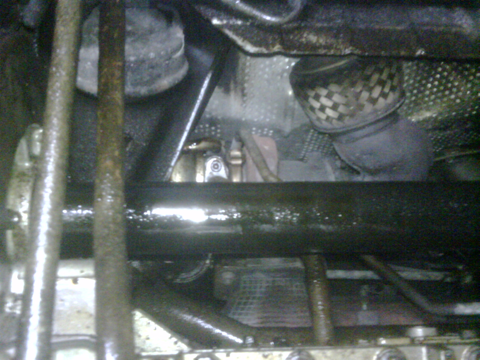

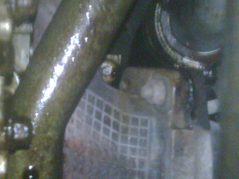

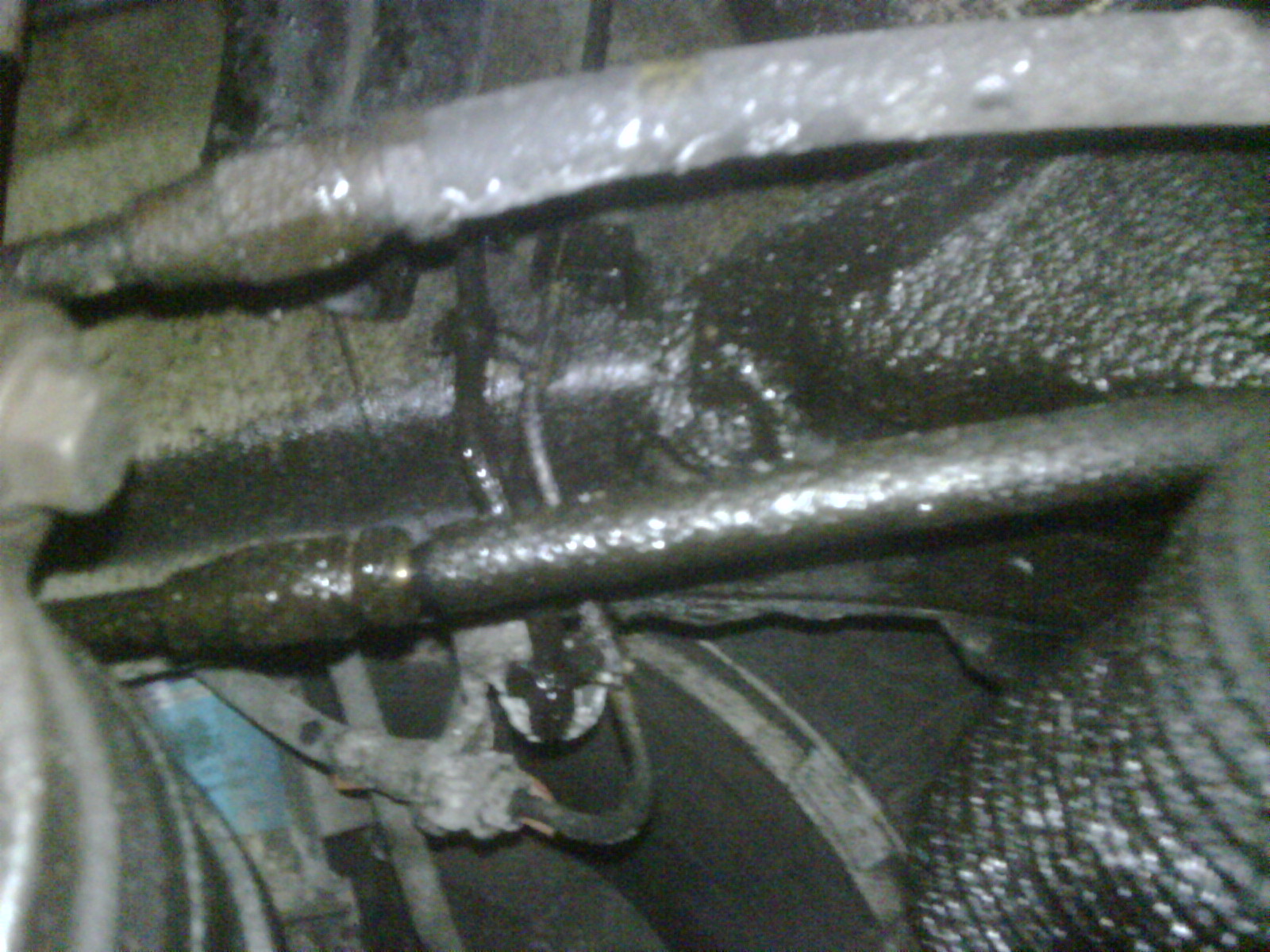

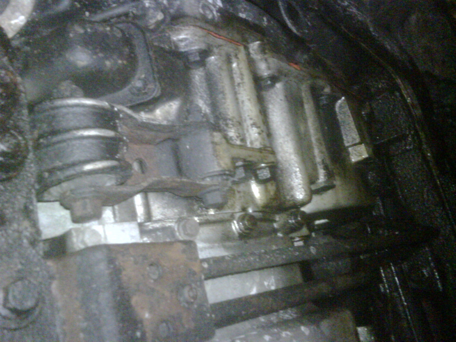

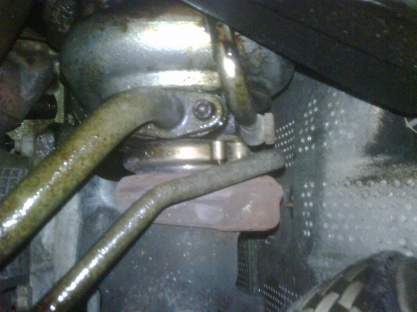

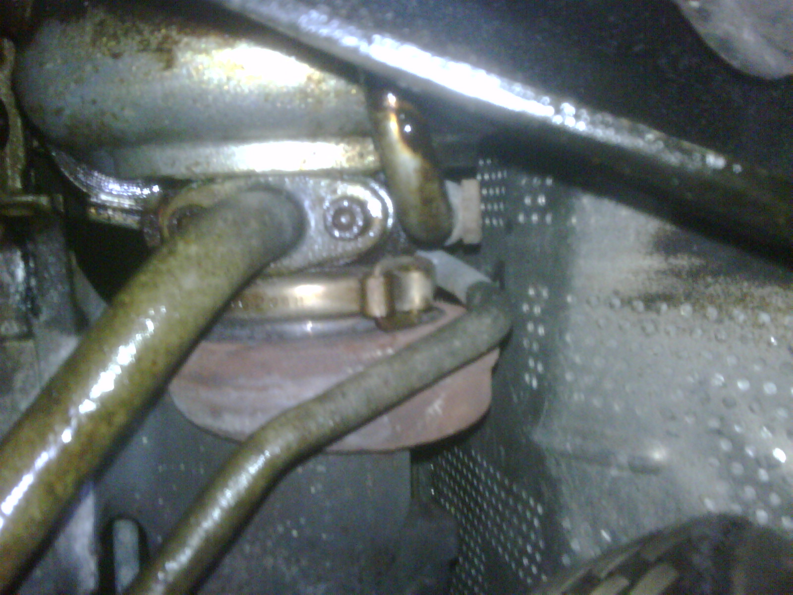

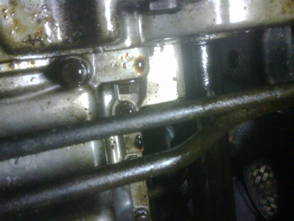

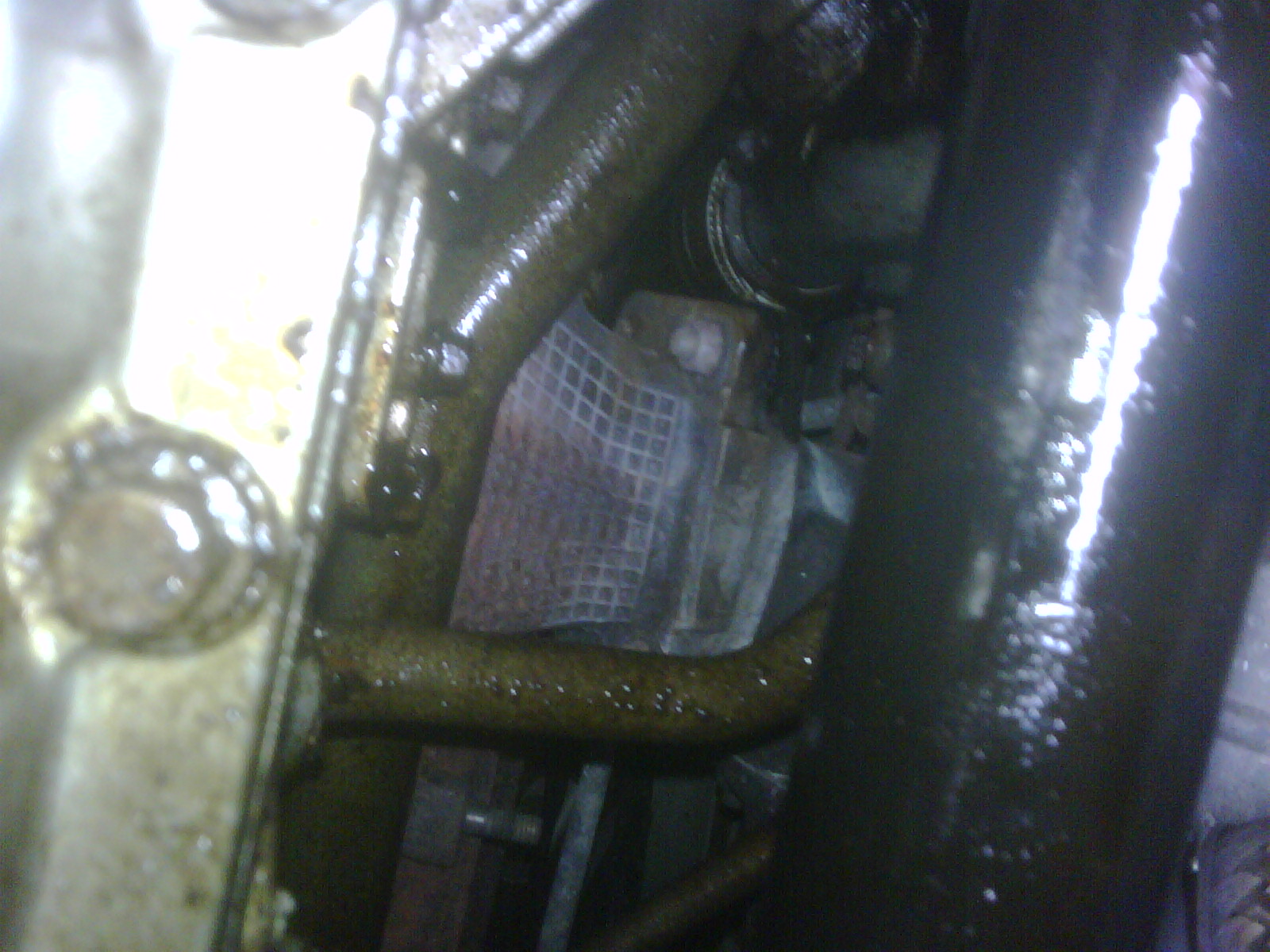

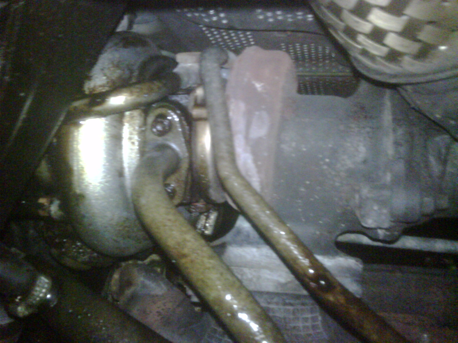

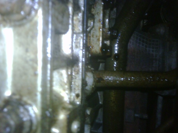

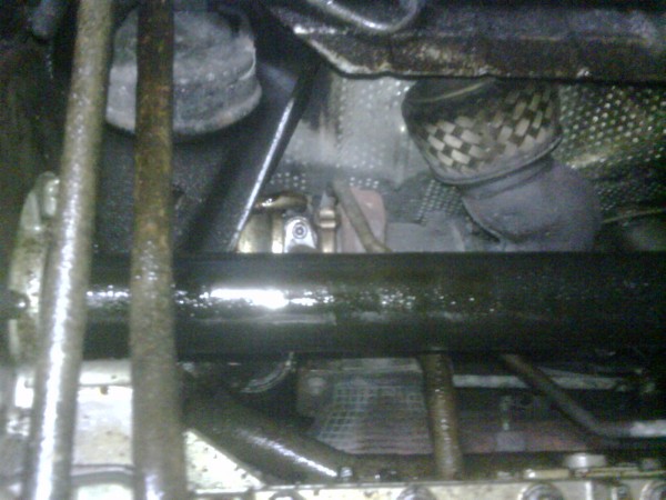

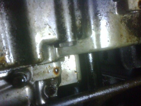

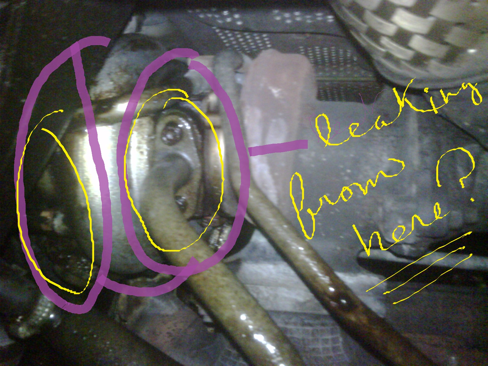

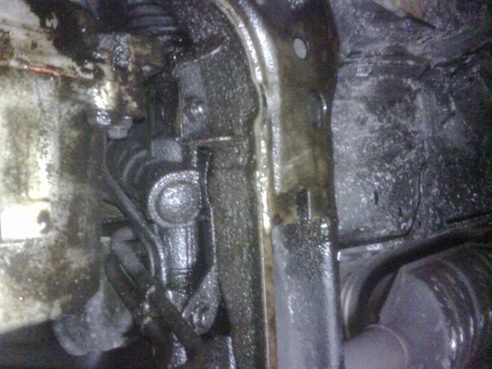

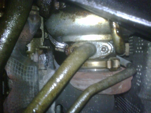

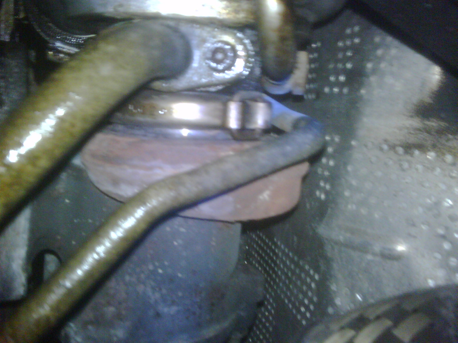

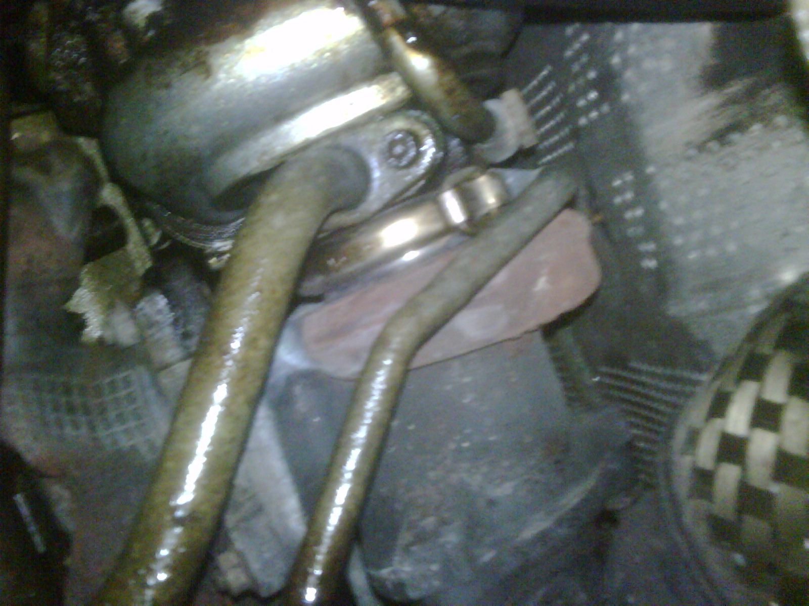

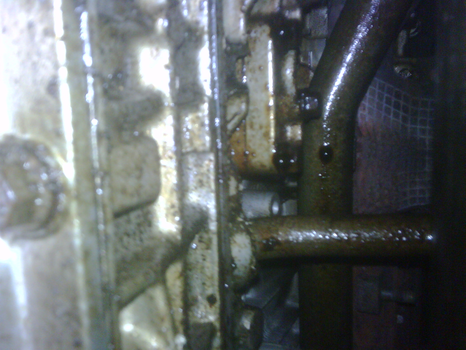

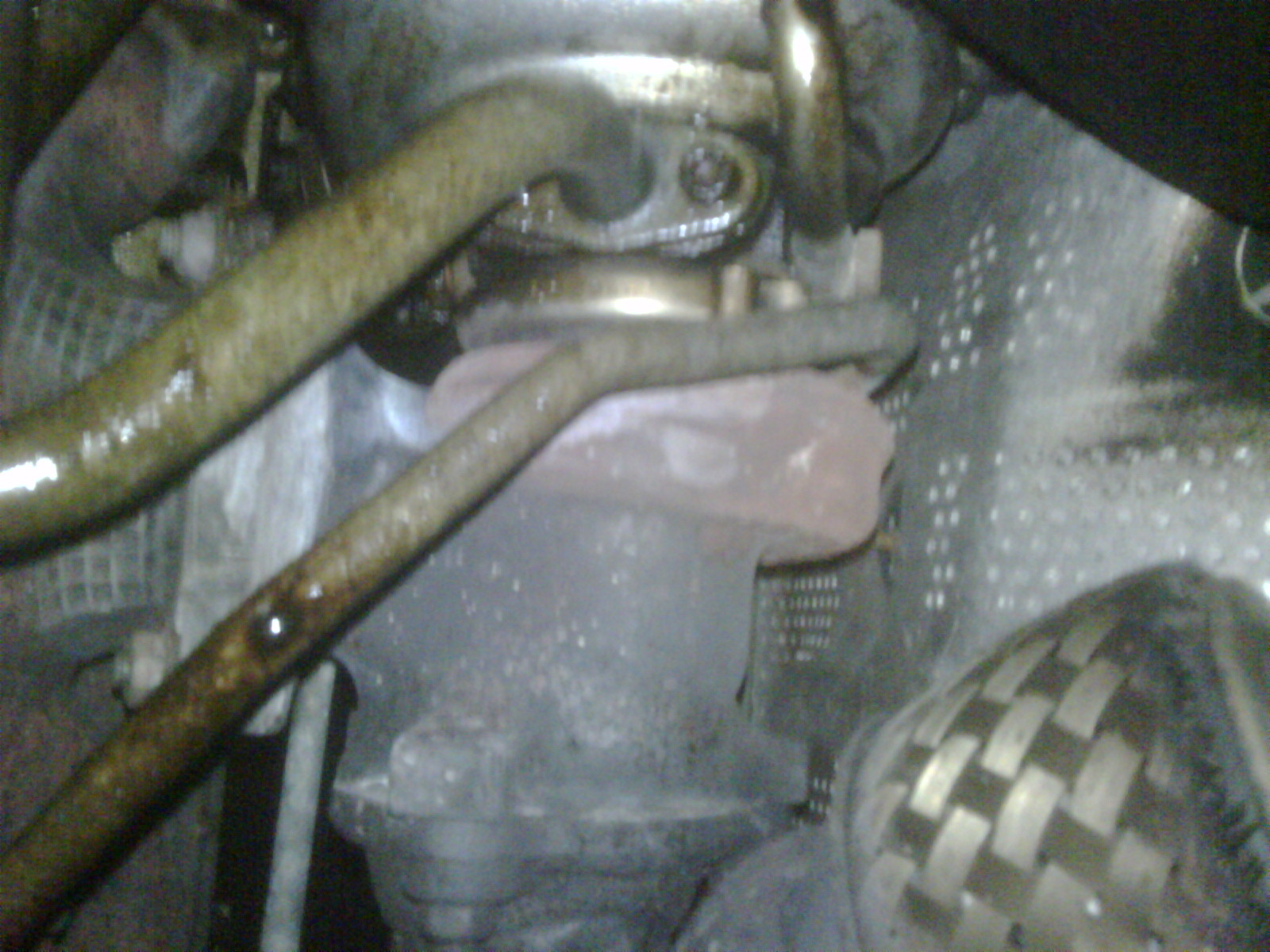

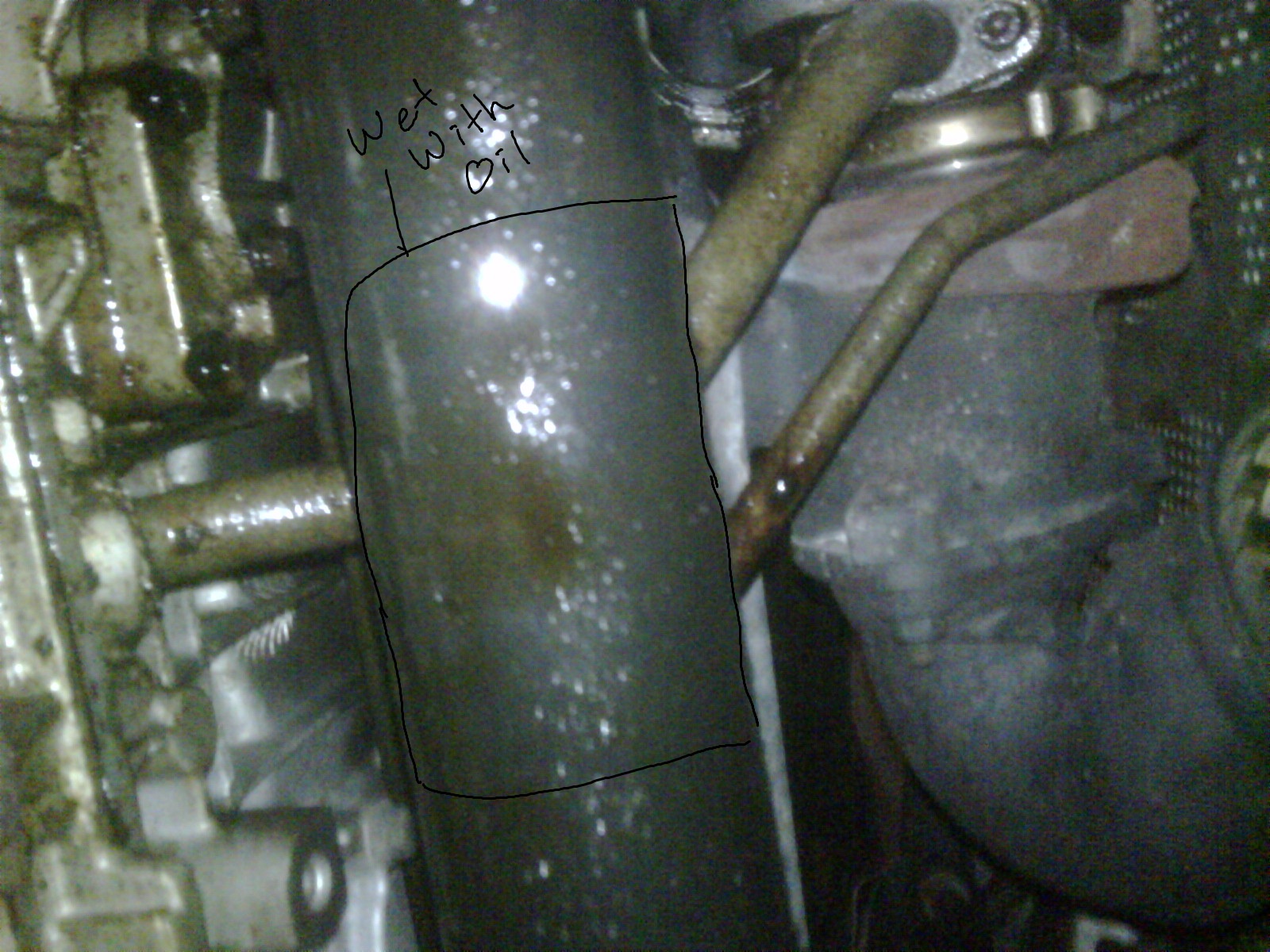

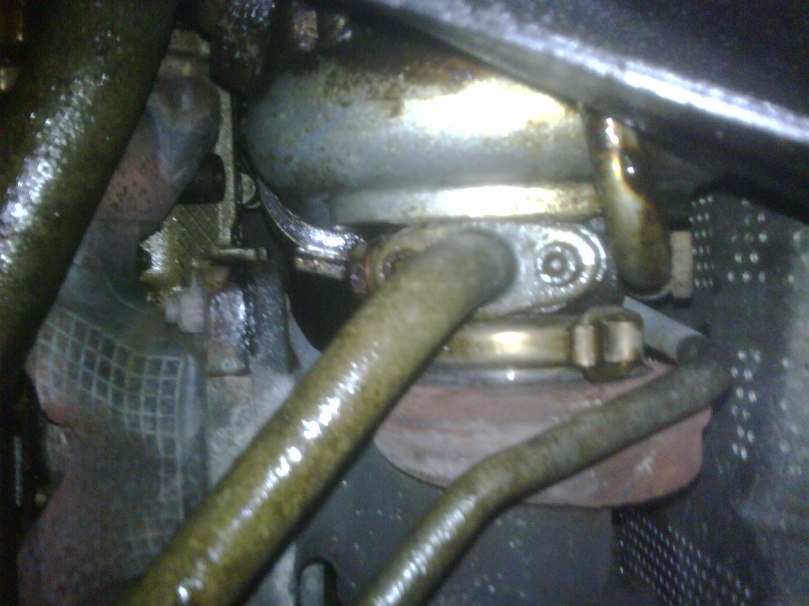

Good Evening everyone,
So I used to have the worst leaking you could ever imagine... At first I would run out of oil in 5000 miles or so...it got so bad that 1000 miles was a longshot...the source bad oil cap gasket(just replaced the whole cap). I believe this may have solved alot of my oil leak problem...but it's still to early to say...
I still have another oil leak near the turbo(I think). It's annoying because every light(literally) I stop at and have the heater on I get the burning oil smell (I might even see smoke coming from under the hood)...When crusing I never experience this...but as soon as I stop the smell surrounds me...and its toxic too!!!! :evil: :evil: :evil: :x :x :x
So tonight I thought I'd get to the bottom of this wasn't that easy as I'm a newbie when it comes to car mechanics...but I did snap some pictures ...and was looking to get the authoritative consensus from the best best Volvo community members of all!
I hope I haven't gone overkill with the pictures...if anyone would like me to snap some more I would gladly do so 8) :D
upon visual inspection..It seems to me like the circled spots are where all the oil is coming from...

It looks like you actually have a combination of a leaking turbo oil return line, AND a clogged PCV. The oil is blowing past the rear seal and leaking on the hot exhaust manifold and all over the turbo.
PLEASE change out the PCV (and clean the PTC nipple at back by the turbo) as soon as possible and you may be able to save it. My smell had been getting really horrible, and I'm fairly sure my car blew out the rear main seal while driving to NC today. It's bleeding oil all over the bottom of the car and driveway like a stuck pig, and it's dark so I can't really pinpoint where it's coming from.
I did my whole PCV system about 2 weeks ago, after putting it off for a long time, but apparently it was too little too late. I smelled burning oil even with the air off and windows down every time I got on the gas to go up a hill today.
There's a great write-up that I followed here: http://www.lakesidedp.com/uploadpics/pcv/index.html
Replacing the rear seal is not for the faint of heart - I'm not even going to attempt it myself, so it's best if you can still save it!

I am lost in your pictures... but I do know one thing you can do to help your situation.
Get a few cans of oil-cleaner to rid the engine of its excess exterior oil and do your best to clean off as much oil as you can (I'm not talking about detailing stuff). By the looks of things you may need a few cans, and... do not spray them on a hot engine, lol. Engine fires are not fun.
After you've cleaned as much as you can drive it and continually look for the leaks.
Hope this helps a little bit.

jablackburn wrote:It looks like you actually have a combination of a leaking turbo oil return line, AND a clogged PCV. The oil is blowing past the rear seal and leaking on the hot exhaust manifold and all over the turbo.
Hey Jack Thanks for the reply,
Here's the thing though, there is no smoke coming from the dipstick at all (I agree with you on the return line though)
I also was thinking PCV system...but with no smoke from the disptick is that likely?

I suppose it could be possible for you to not see any pressure - it depends on where else pressure is escaping from. First, it was around your oil cap. Since you replaced the gasket, that opportunity has been sealed off from it and it's blowing out the seals instead. At least that's what I'm thinking.
I agree, give the engine a good cleaning-up and see where oil re-appears. It's kind of all over everything at the moment. Take off the turbo heat shield at the back of the engine and have a look around there. In the meantime, don't romp on the throttle a whole lot.
What kind of oil do you use?

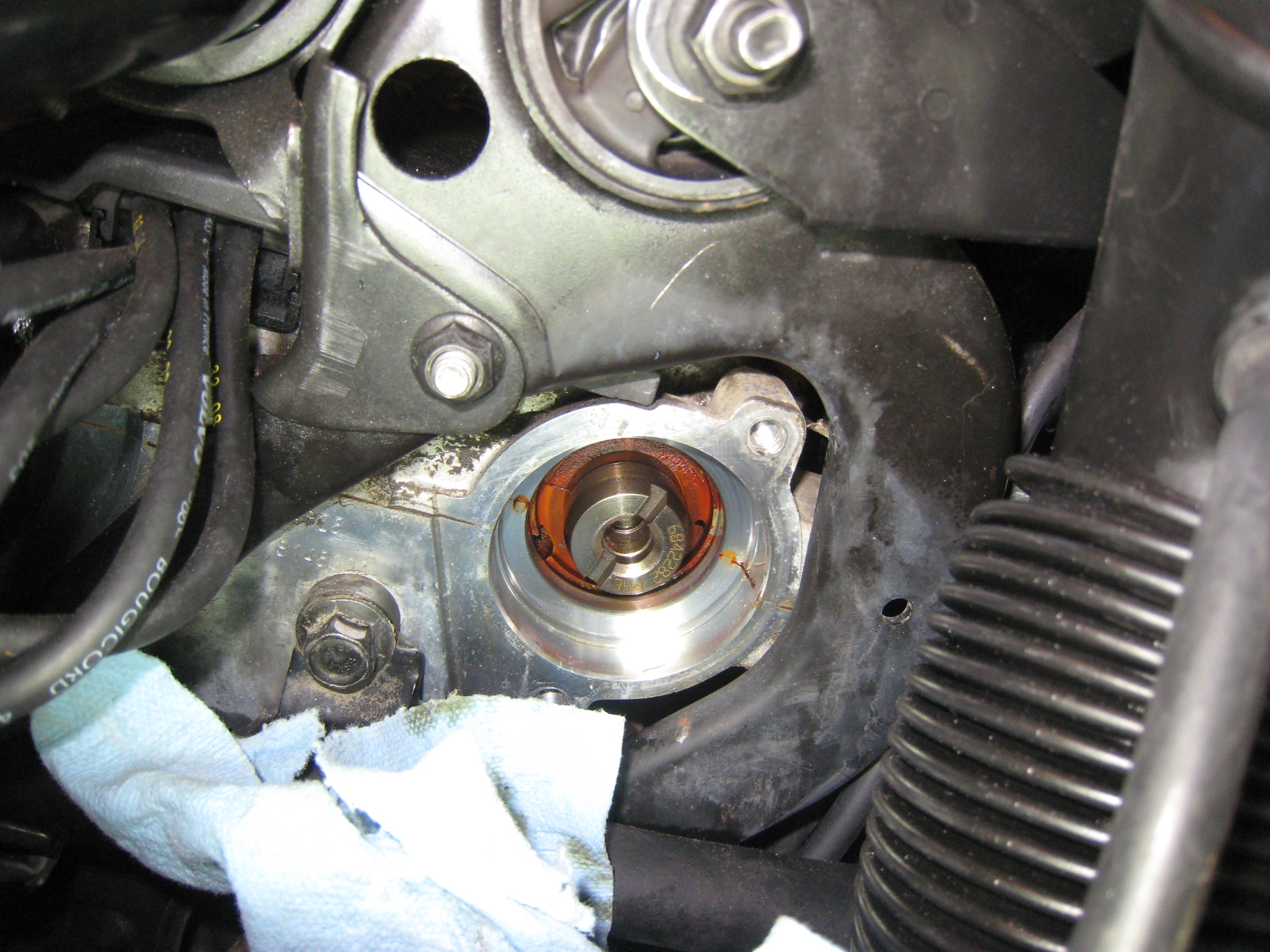

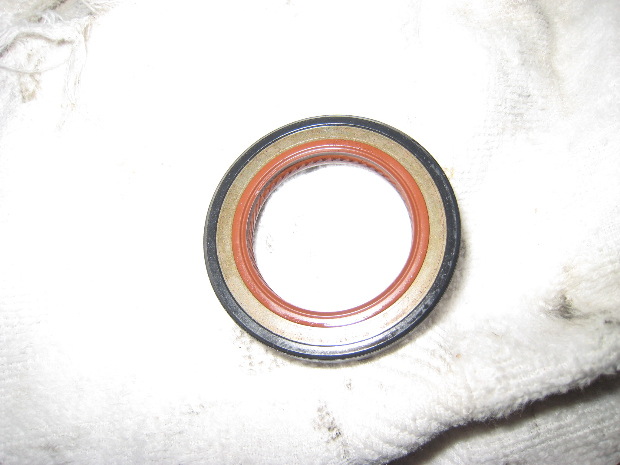

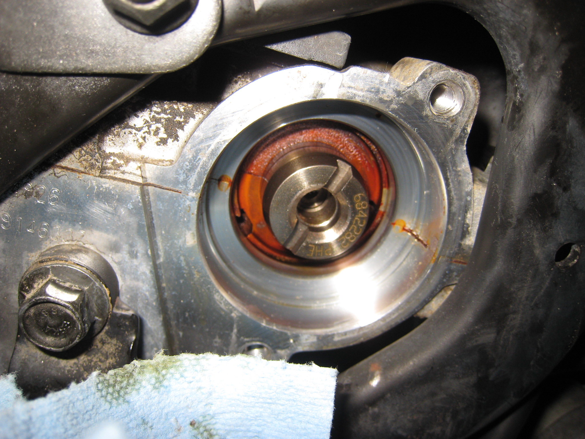

We had the same oil leak in our 1997 850R. It turned out to be the turbo drain line, and the cam shaft seals, behind the cam position sensor, and the distributor cap. We also changed our flame trap system, which was pretty gunked up.
I'll add some pictures of ours.
Good luck, hope this helps.
Seal out
Seal out
Rear seal behind cam position sensor

pkc303 wrote:We had the same oil leak in our 1997 850R. It turned out to be the turbo drain line, and the cam shaft seals, behind the cam position sensor, and the distributor cap. We also changed our flame trap system, which was pretty gunked up.
Thanks for the photos and the" been there done that"...lol
hmm Jack what do you think?...oh man :| :| :? :? :?
