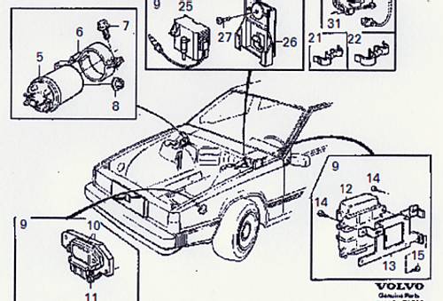

This shows the location according to VADIS, parts 5, 6, 7 & 8:
I have asked my friendly Volvo tech and he can't remember a 700 having the coil mounted behind the engine.
As I said in my earlier post you have replaced one coil and have developed the same problem, and now it seems to have been a problem since new. Perhaps you should consider moving the coil.
