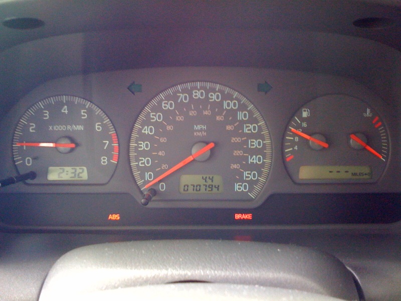

A few weeks ago these lights started to come up every now and then, but now they are on all the time. As a result my speedometer does not work, neither does the trip computer control panel and the Cruise control. Every now and then (very rarely) everything works again for a few minutes when I start the car in the mornings but after a few minutes the same problem occurs.

These are the lights that are on all the time!

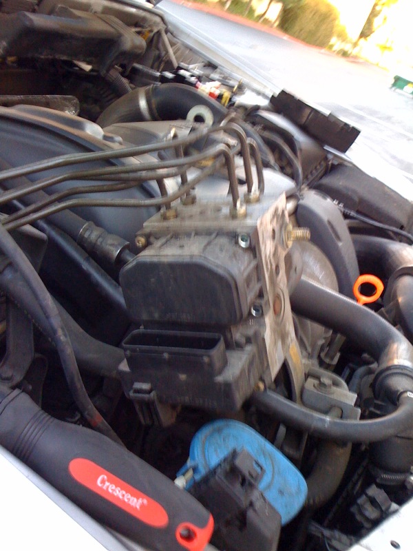

I found out that I can take the ABS module and still drive the car (of course under my own risk). So I took the ABS unit yesterday it took me about 1 hour. Also for a Volvo s40 you don't need the special tool (Torx wrench (socket) E5) to take it off, all you need is a T20 socket (see pic)
T20 Socket for removal of the 6 screws

Here are some pictures
Volvo s40 ABS control unit Removal

I just got the module back yesterday. put the thing back. And it works great! All lights are off now and all my car features work again (Speedometer, cruise control, out side temperature) It took care of the problem!
And the guy Victor, very easy to work with plus he is very fast, will highly recommend him to repair ABS units
I spent 160 US dollars total VS $1000 at the dealership. I say is a win!
Hope this is helpful for you!

@JhonC - THANK YOU!! My mechanic quoted me $1200 for this repair. I followed your instructions, sent the ABS Control Unit to Victor Rocha at http://home.earthlink.net/~vicrocha/Vol ... 70_ABS.htm ([email protected]), and 1 week later I was back in business at a total cost of $115!!
It took about an hour to remove the unit, a bit less to reinstall. I did need to unbolt the power steering fluid reservoir and two brake line clips in order to lift the ABS unit high enough to get access to the Control Unit. Other than that - easy-peasy!
Thank you again for starting this thread, and for ultimately saving me over $1000!
