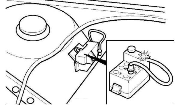

Well, then i think i got an exeption, since i cannot find the unit anywhere.. (like the engine starter..) how big is it supposed to be?
and there must be a total of 9 led ligts in it?(3 for euch group?)

Post by billofdurham »
This picture show the OBD unit and its location.
There is only one LED, as shown in the picture. If codes are set in the OBD the LED will flash the first number (e.g.1), pause then flash the second number (e.g. 2), pause and flash the third number (e.g. 3). If more than one code is set there will be a pause of three seconds before the next code is displayed.
I haven't measured the OBD unit but it isn't very big.
