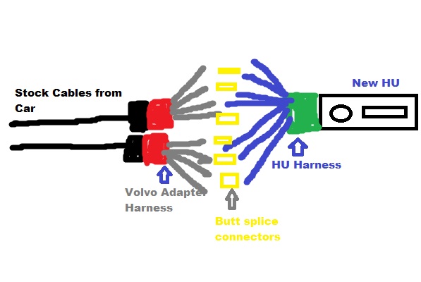

It's pretty simple to do, and Crutchfield's tech support is amazing! They'll help you with anything!
You basically plug in the adapter harness into the one that comes from the car's speakers (the one that unplugs from the stock radio). Then you take the harness that came with your new head unit, plug it in to the head unit, and then splice the wires from that one to the adapter harness that comes from the car. They are color coded, and the instructions provided are spot on.
It may seem daunting at first, trust me, I was horrified when I saw all the wires. But again, the instructions that come with are very handy! I recommend using the butt splice crimp connectors. Much easier than dealing with soldering.
All 8 of my speakers still work flawlessly!
The setup is something like this (pardon my bad "Paint" job!
- Radio!.jpg (41.71 KiB) Viewed 5572 times
