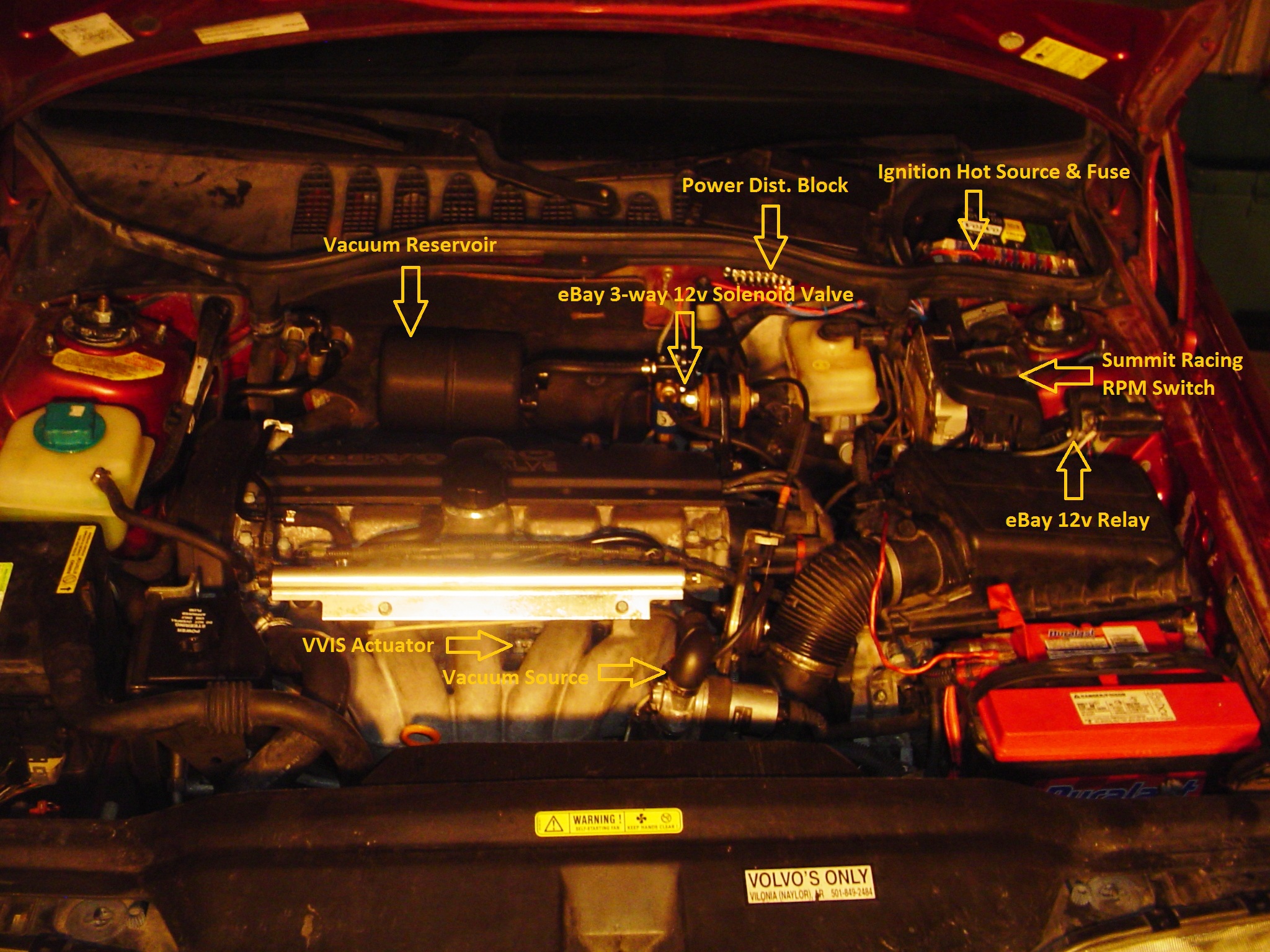

So this was my initial plan of attack:
I wound up substituting one 3-way solenoid in place of the the two solenoids in the crude diagram.
This is what I wound up with: Here's what I used:
Summit Racing RPM Switch
Summit Racing Vacuum Reservoir
Summit Racing Vacuum Gauge <- Junk & not necessary, just plugs a hole. Reads 15 in/Hg with no Vacuum applied, maybe I got a bad one.
12v 3-Way Solenoid Valve from eBay
12v 30 Amp Relay from eBay
1/8" ID Rubber Fuel/Vacuum Hose
3/8" ID Rubber Fuel/Vacuum Hose
Various & Sundry 1/4" Brass Fittings, i.e. Street 90s, Hose Barbs, Unions, etc.
Radio Shack Power Distribution Block & Jumper Strip
Hose Clamps, Zip-ties, Fuse holder, wire, terminals, and heat shrink tubing
It works (in the garage anyway) I got everything buttoned up, zip-tied out of the way tonight. I'll test drive tomorrow, and hopefully get some video of everything working. I've got a ton more pictures, and will attempt to make this all make sense in more detail.
- Lee
- Lee

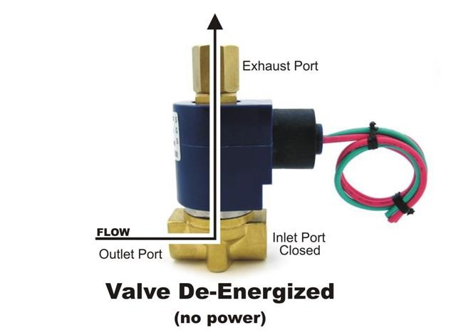

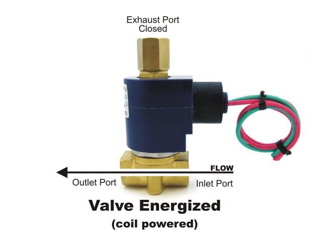

Here's how the 3-Way Solenoid works:
The solenoid is what controls the vacuum to the VVIS actuator. The RPM Switch "turns off" at a set RPM (currently 3700 RPM) which "turns off" the relay that is controling the solenoid. The idea is that @ >3700 RPM the solenoid valve is de-energized and the VVIS actuator is under no vacuum, it is open to the atmosphere. Currently @ <3700 RPM the solenoid valve is energized and allows vacuum from the vacuum reservoir/engine to activate and close the VVIS "shutter" in the intake manifold.
Clear as mud?
- Lee
Clear as mud?
- Lee
