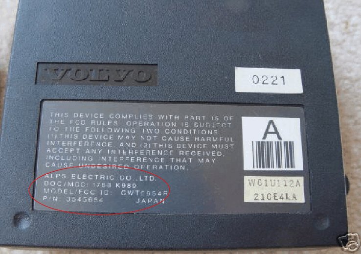

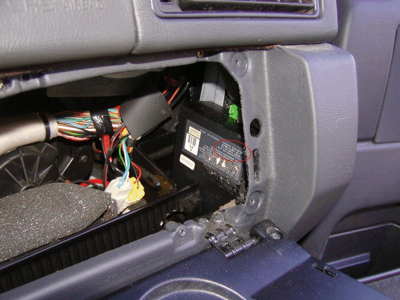

This is very simple, pull the glove box and look at the A pillar for a box that looks like this:
remote receiver.jpg (111.01 KiB) Viewed 2637 times
Credit to the original photographer but that picture shows the factory unit upside down.
If you have such a box you are golden, all you need is the keyfob but you need to get the FCC identifier and the part number off of the receiver to get the correct one. There are two versions that look identical but they are incompatible. The eBay sellers are clueless and call both versions out as '93 to '97.
The numbers you need to look at are circled here:
If you don't have the box I bought a complete system from an early model and installed it in my son's '96 and it worked fine but I got the receiver and the remotes in the deal - interestingly for less money than the price of just the average keyfob. It all works OK so long as the keyfob and the receiver are the same versions. You will need to re-program the system one they are installed but that is a very easy Key On/Key Off for 5 times and press the lock button thing that is detailed in the repair database.
