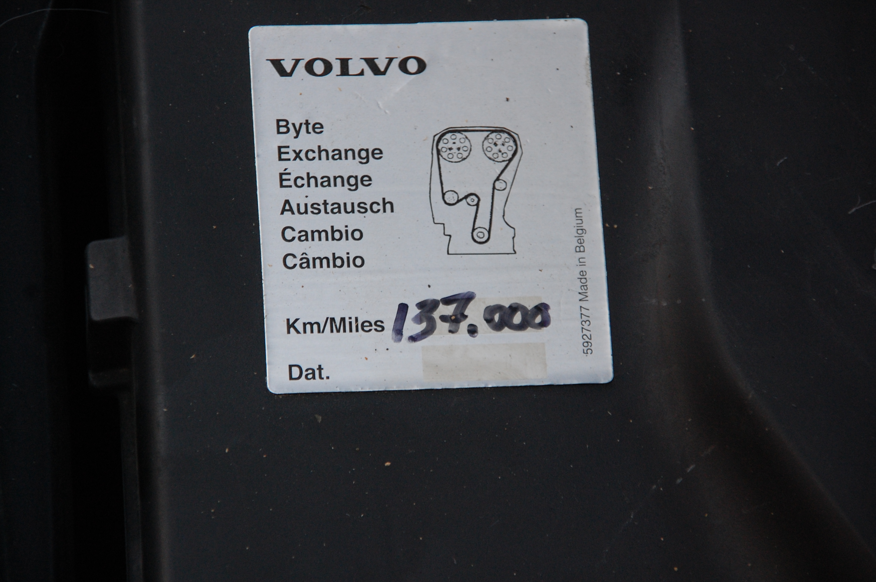

I know I'm going to have to "bite the bullet" on the timing belt, but I'm still very mad about it. Who ever put on the last sticker just labeled it 137000, so I don't know if that means they replaced it at that mileage, or thats when it needed to be replaced. I would hate to replace a brand new timing belt! I may try doing one of those VIN history lookups a la Carfax.

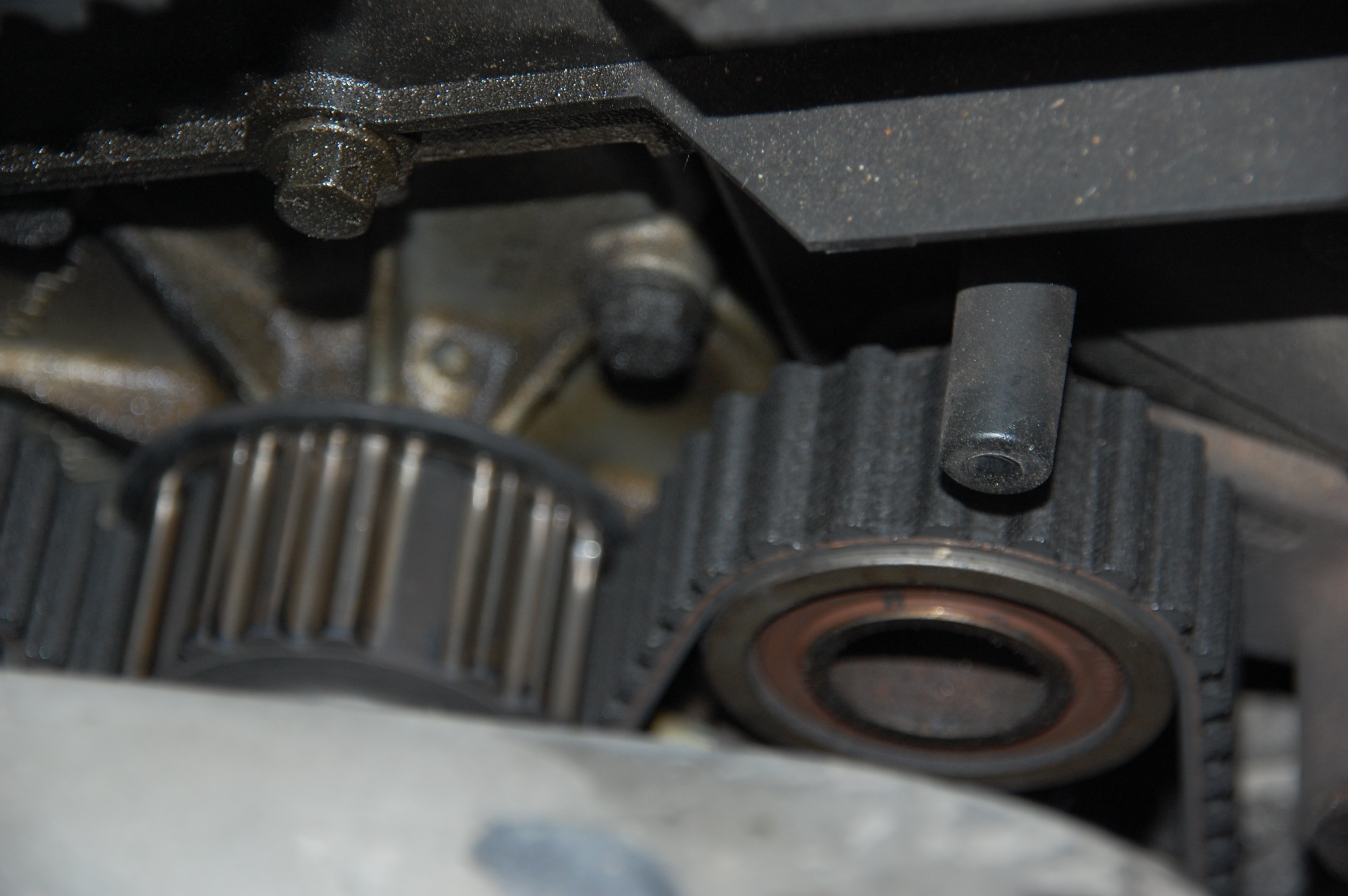

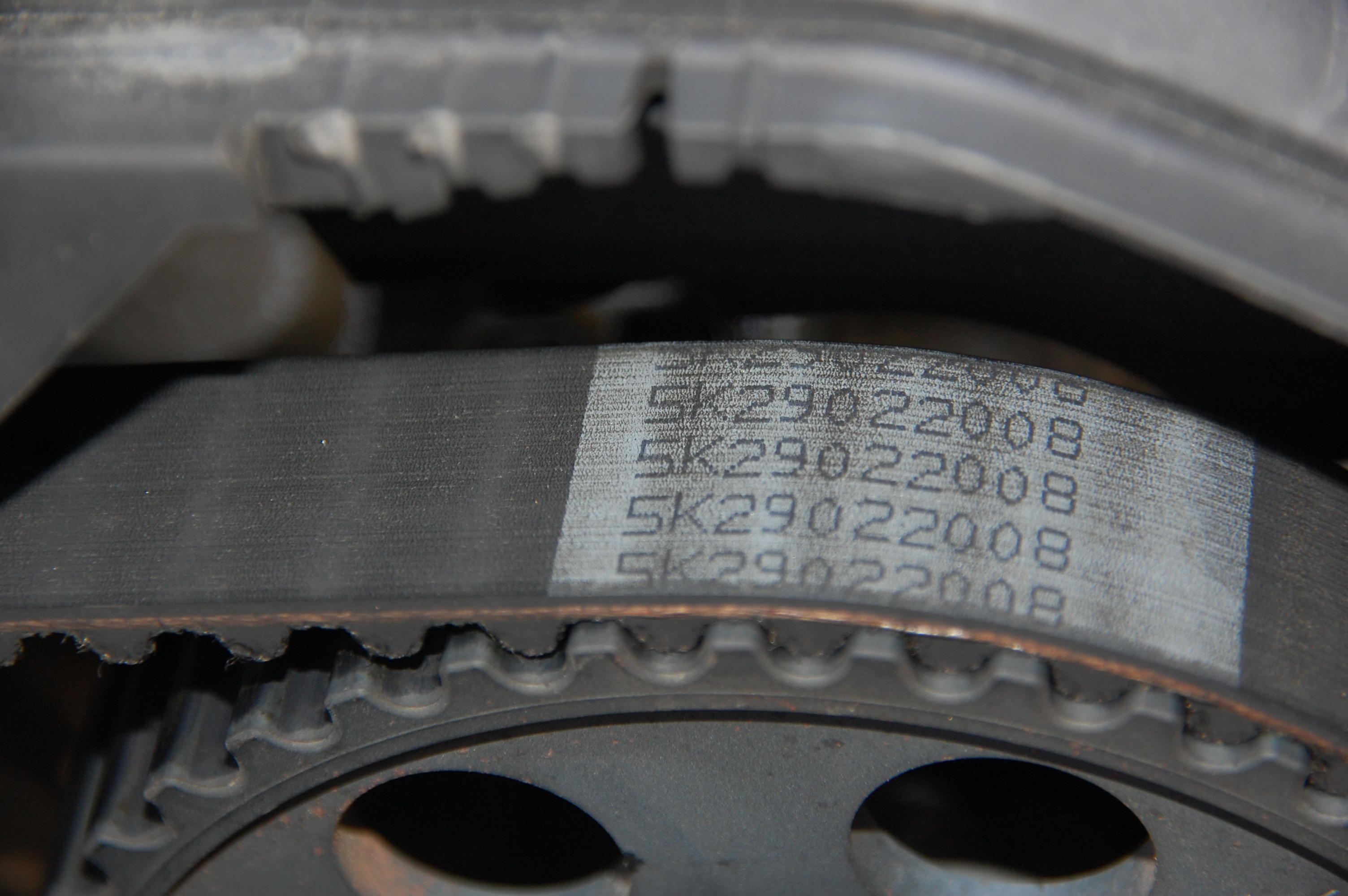

Remove the Plastic Cover the Timing Belt (12-mm bolt, 2nd pic in link below).
Then take a detailed pic of your TB area and post it here for the guru to look.
http://volvospeed.com/Repair/timingbelt.php

Has anyone ever seen that sticker filled out with the NEXT time to change the belt rather than the mileage at which it was just changed?
My only worry is that since your odometer is stuck at 137K, the fact that this sticker says 137K gives no information about how many miles have elapsed since the belt change.

Mine has the mileage that it was changed AT...and within 35,000 miles the sticker's all beat up and peeling off.
But your belt actually looks to be in very good shape, if not new.
This is why we try to pressure buyers to get a car with a well-documented service history, but I know sometimes they can't be avoided if the car is just too nice. You might try the Carfax thing, though I'm not sure if they list all services done to a car there. I believe the ones I looked at only had emissions inspections, accidents, and title changes on their histories.
If you can't find any more information, my advice would be to change both the belt and the tensioner. That way, you'll definitely have peace of mind about it.
