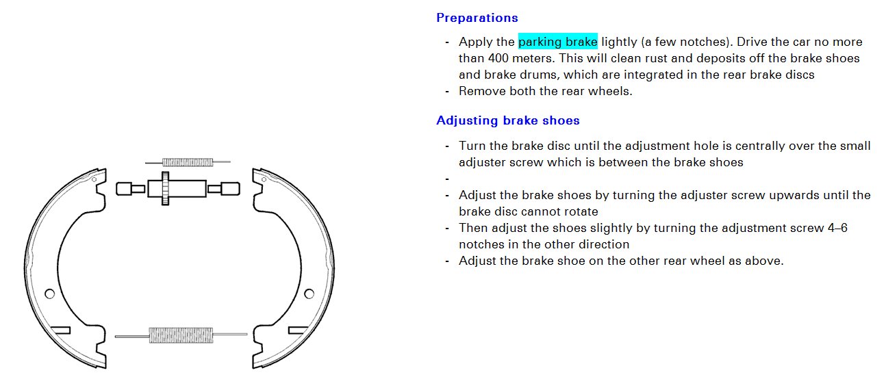

Here are the instructions for adjusting the shoes inside the rear rotors:

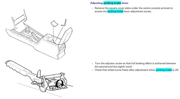

And here's the Cable Adjustment to make after setting the shoes:

If adjusting still doesn't make them work then you may have either a seized or broken cable. If one of the cables is either seized or broken it effectively kills both of the rear hand brakes since the bar at the base of the handle where the cables are attached skews towards the path of least resistance.
The cables need to both be free and both be of more or less equal length for the system to work properly.

The parking brakes can be refered to as drum brakes. I am going to assume that you did not use brake cleaner on the drum (rotor) where the new pads will rub. That needs to be done, as well as using brake cleaner on the new shoes.
Once the rotor is back on, adjust the star wheel until the shoes touch the drum firmly. Then back off 2 clicks, the wheel should now turn easily. Of course, you need to do this on both sides and slacken the cables before you start.
The cable adjuster in the cabin needs to be tightened. Watch the bar that connects to both cables if you can. As you tighten, the bar should remain perpendicular at all times - meaning that both rear brakes are going to be treated equally.

The cables really don't stretch beyond the initial use, so if they aren't right, something is wrong in the parking/emergency/hand brake or the cables are breaking.
Scrapes and noises are normal in drum brakes. If you adjust them more than 5 clicks from the no-turn condition you have gone too far.
