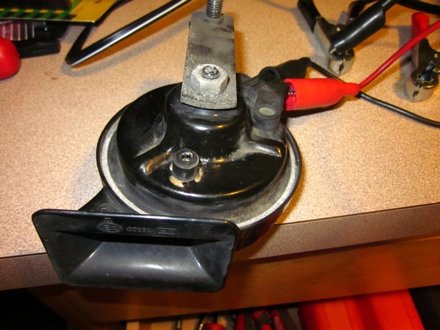

I had a non-operational low horn (Mixo TR99, Volvo part 9169551) that I fixed by removing the cap and adjusting the Torx 20 screw.
Horn after removal from car.  Cap is covering the torx 20 screw.
After you lift off the cap, the screw can be adjusted with a T-20 driver. I needed to turn mine about 1/3 of a turn counter-clockwise to get it working again. I took the precaution of marking the original setting of the Torx bolt with a little black marker so I could keep track of where I started out.
