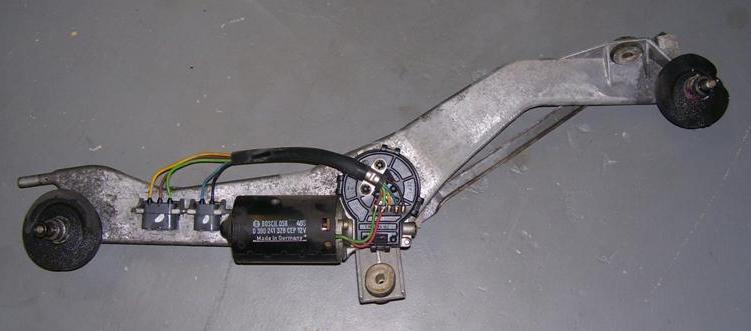

well, now I'm hosed. at least, my current parts are hosed.
I bent and broke the big metal piece that holds the whole thing together, the frame I guess you'd call it (the big silver part below, I'm pulling this image from the instructions renns linked to above):
I've been trying to get it loose for a few hours, with a combination of crowbars, hammers, etc... Now it's cracked just to the right of motor transmission, where it bends down.
So, now I need a new one. I called my local volvo mechanic, who's got a mini-junkyard at his shop, and he said he'd sell me the wiper assembly, minus the motor because mine is fine, for $90. You guys think that sounds ok?
I also emailed one of the online shops, and while they didn't have it on their site, they said they could get it for me for like ~170 new on a special order. Apparently it's part # 9151782. Not too many results, though, when you google for that part #.
Not totally sure what I'm asking, I guess I just wanted to post an update and vent a bit...

$90.00 is not unreasonable.
...Lee
