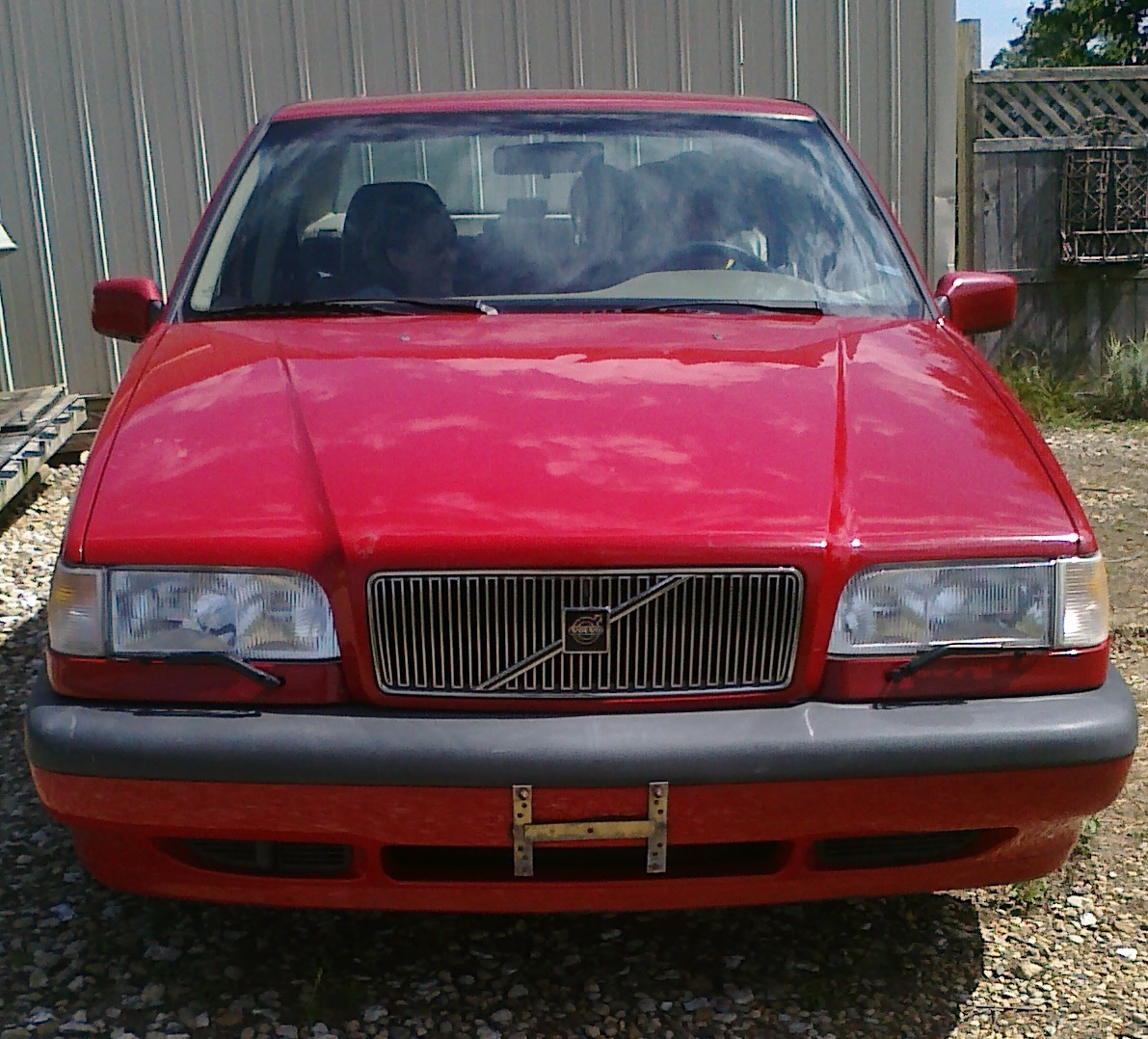

I just got a 1995 850 GLT Volvo for my Girl and looking it over one thing I found is that the window wiper blade comes off the window at about one o-clock on the steering wheel stays off the window till about the same point in the return to rest stop , it looks like a fairly new arm assemble and I put on a new blade ( the one I took off was OME with a wind jam on it but it didn't help it stay on the glass ? ) This is on the drivers side and it leaves the water right in the wrong place to drive safely. Has this ever came up before and what would be the fix , it seems to have good spring tension but not at that point on the glass I can't see a bent shaft ?
- This looks like a well kept car for its age.
- CIMG0271-1.jpg (468.56 KiB) Viewed 3392 times
