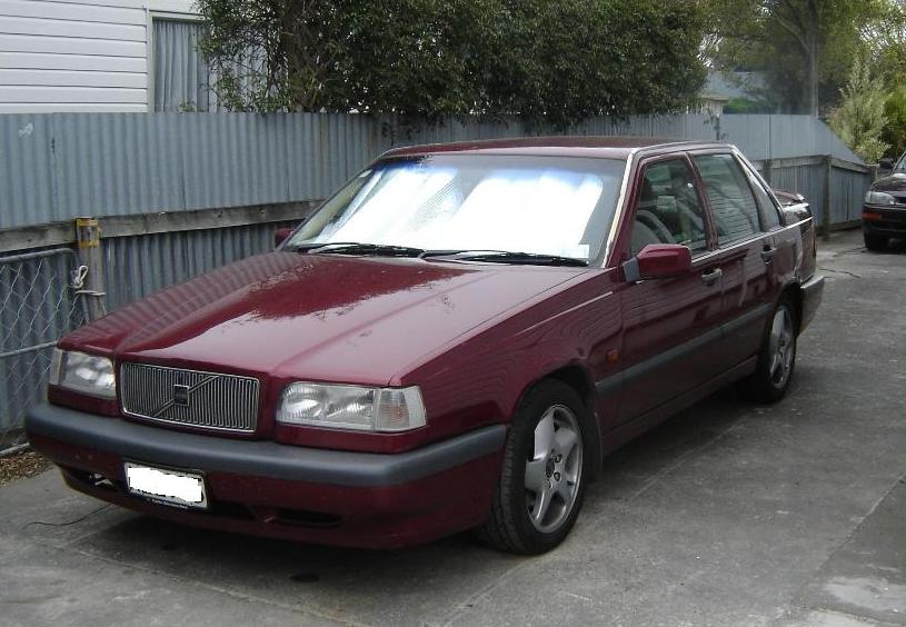

Here she is.
- Oct 6 001.jpg (76.19 KiB) Viewed 2085 times
- Oct 6 002.jpg (68.71 KiB) Viewed 2085 times
