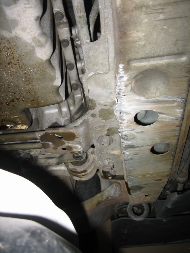

Someone who shall remain nameless drove the 850 over a curb on the way home last night. This morning I found the car parked in a giant puddle of its own oil. The suspension and tires seem to be ok. The aluminum subframe took the brunt of the damage and the oil pan was left with a 1/2" long incision. Replacing the oil pan is the obvious solution but after really looking into it, I think I'm going to give JB weld a shot first.
The sandy looking stuff on the oil pan is the cat litter I used to soak up the oil on the floor.
thats a bummer.. As important as that oil pan is i wouldnt mess with jb weld. Its not that difficult to replace the oil pan id get one from a junkyard and go from there.
What a bummer... I've fixed a of the stamped steel tranny pans in the past by removing and brazing the damaged section. For a cast pan like this one, it's not quite as easy. JB Weld might work, but to really do a good job you'll want to drop the pan to inspect from inside and clean all oil residue from around the crack region. At that point, you may as well put on a replacement pan if you can find one at a reasonable price. Good luck with the repair, and driver-training for 'nameless'!

Well, the deed is done. I have to give the JBweld 24 hours to cure then fill it up with oil and let it sit for another 24 hours. If there's no leaks I'll take it for a spin.

I did a similiar patch, the first attempt lasted a few months then the oil made its way through the small voids between the case and the JB weld. Second time I added some fiberglass mat with the JB weld and made the patch larger. It has held for 2 yrs. I would have welded a patch but the case is magnesium.
Not sure what the 850 oil pan is but welding a patch may be a better fix if the JB does not hold. Thats a pretty big hole.
After 2 coats of BJweld and 3 days to cure, I filled it up with some cheap oil and took it out for a spin. The engine seems healthy thank god. Now I'm going to let it sit for another day and check for any leaks. So far, so good.
You need to keep checking that on a regular basis, the different expansion rates of the alloy vs JB Weld could cause the bond to let go resulting in another leak, I would only treat the JB as an interim solution for a week or two while you locate a replacement pan - Mike
