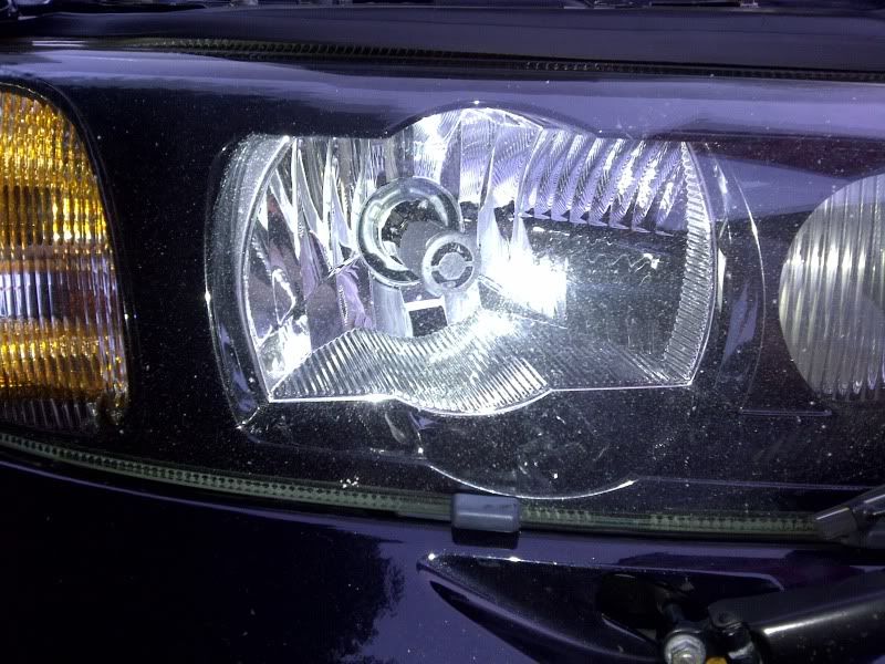

2004 s60 2.5T AWD
Bought new low beam bulbs from "Daniel Stern"'s website to improve nightime vision which is very poor.
Manual says it should be a H7 55W
Bought a good one from Stern.
Went to install per manual's instruction and found this:
Please help as I damaged the old bulb pulling it out. I take it these are Halogen but don"t know why they are on this car as I never replaced them and bought it CPO from the dealer at 8K miles. Maybe someone swapped them out.
Need to know:
-what these are
- options to replace for better nightime vision
-also note that 'highbeam" (#3 on back of manual) never comes on- lights just angle up.
Very confused, thanks,
John

Here is the bulb that I thought was the replacement:

That Phillips bulb that was in your car looks just like an HID lamp.
Google the number on the side of the bulb to be sure.
JimLev
Posts: 60
Joined: 2 May 2009
Year and Model: S60, V70, 540BMW
Location: NM
Post by JimLev »
Just did it for you.
http://www.philipsxenon.com/
You must also have a ballast that fires the xenon HID that is mounted behind the headlight assy.
My other car uses these lamps, great light output, I love them.
