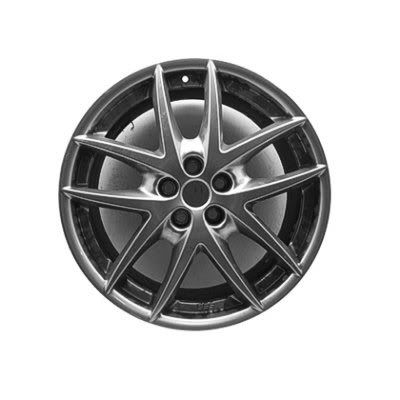

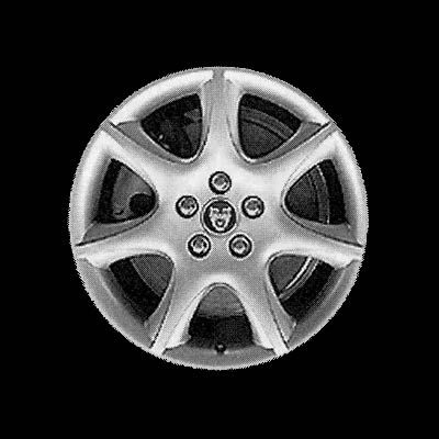

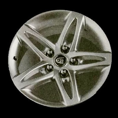

I have been wondering how many people are rolling on Jag wheels. there are about 10 designs from X & S types and Xke's that i would consider if they appeared for the right price on my local craigslist.
i really like these:
and these would do fine as well

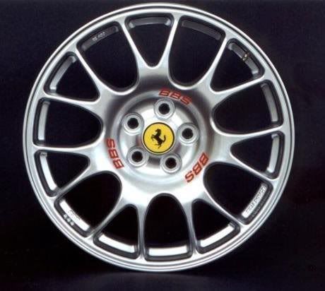

maybe i will just save for a number of years and get these though :roll:

Most, if not all, do not work
They have a RWD offset and won't work on a FWD car
If they did you would find many would run them, I don't know of anyone who does

i have been reading how narrow our wheel wells are and do believe it would be tight.
where there is a will there's a way though, no?
* it seems type S/X wheels are about a +40 ET
