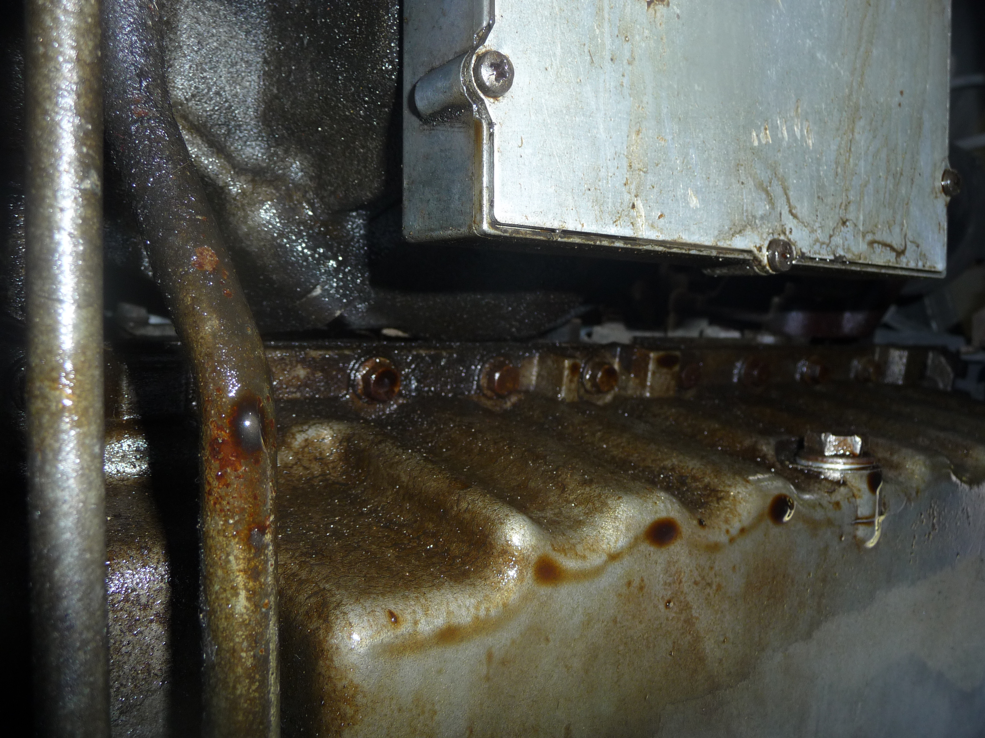

My 98 v70's minor oil leak has sprung into a gusher. It seems to be coming from the turbo but I'm unsure where. From what I've read there are two spots; oil in or oil out lines. I can't see either of these lines from above (but I'm not sure what they look like) and it looks like quite a reach from below. Is this a do it yourself kind of fix? What parts would I need, the lines or just gaskets or o-rings? Here's some photos...

The best thing to do in this situation is to first clean all the oil off the turbo and surrounding area. Then, run the car and see if you can see any oil dripping. 9 times out of 10, the oil return line (which is a hard metal tube that runs out the bottom of the turbo) is the source of the leak. The oil inlet line is a hard, metal line that attaches to the top of the turbo, between the compressor and exhaust turbines.
Check those areas out first and then go from there.

There's the oil return line, that big fat one. That's the most common one to leak, or the rear cam seal from above, behind the dist. cap can make that happen too.
You'll need to clean it off before you can actually see what's coming from where, though.

Thanks, I'll do some cleaning and check into those tomorrow. If it is the turbo return line, is it usually just the gasket that gives up and what's the best way to access it bearing in mind it's an AWD?

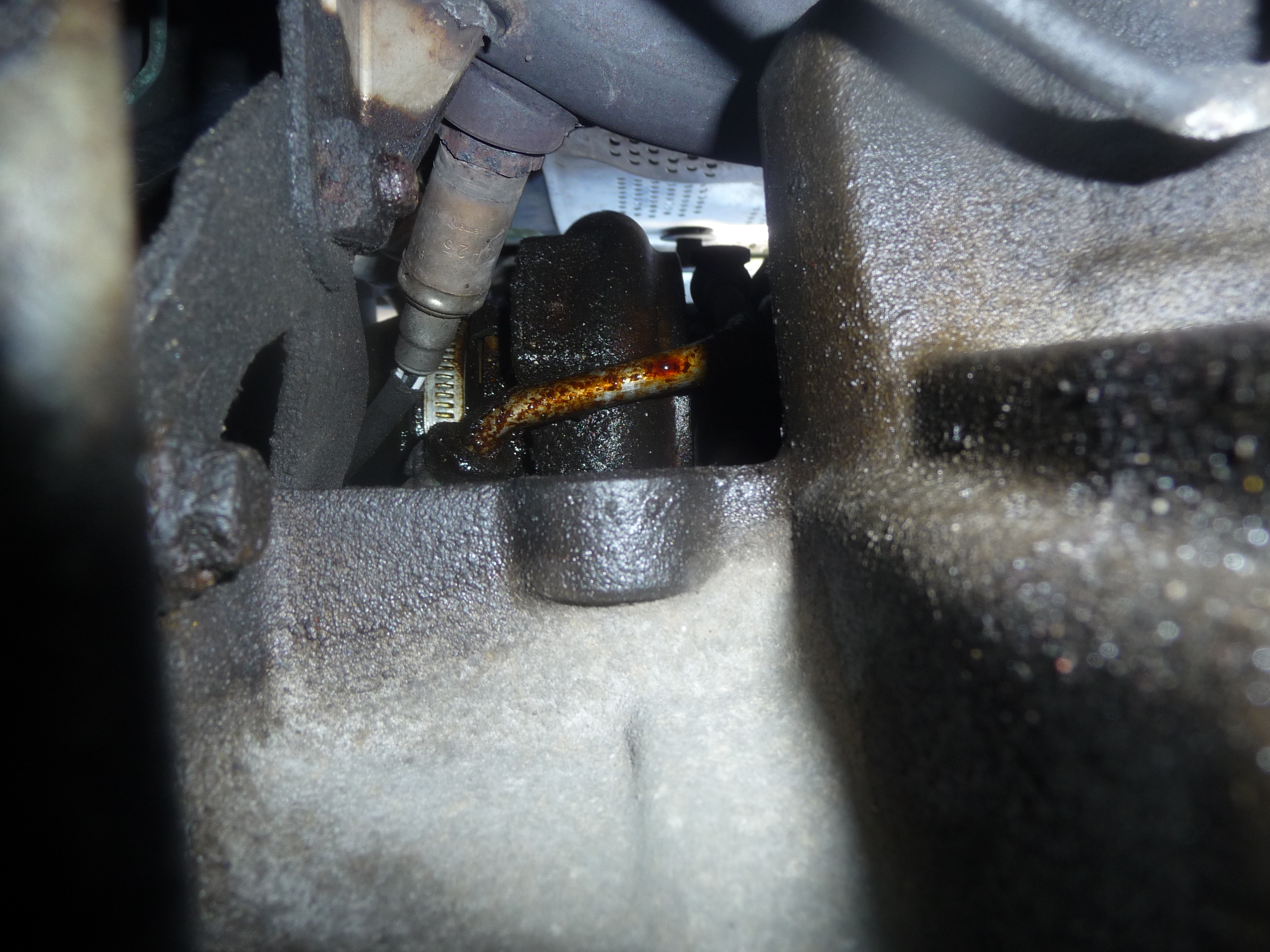

Well, I finally took a stab at this today. When I posted this topic I had only snapped a few photos to get an idea what I'm up against. Upon a closer looks it seems as though the leak is coming from the oil inlet line where it connects to the rubber line. The rubber has become very gummy as you can see in the first photo right below to the O2 sensor. As it turns out, it is very hard to reach with the transfer case in the way - I can barely get one hand up there. I'm going to take the steel line off from above this weekend. What is the fitting called that attaches to the turbo and is it reuseable? I plan to take the line off the turbo and the rubber engine side in one piece, then replace the rubber portion with it out of the car.
