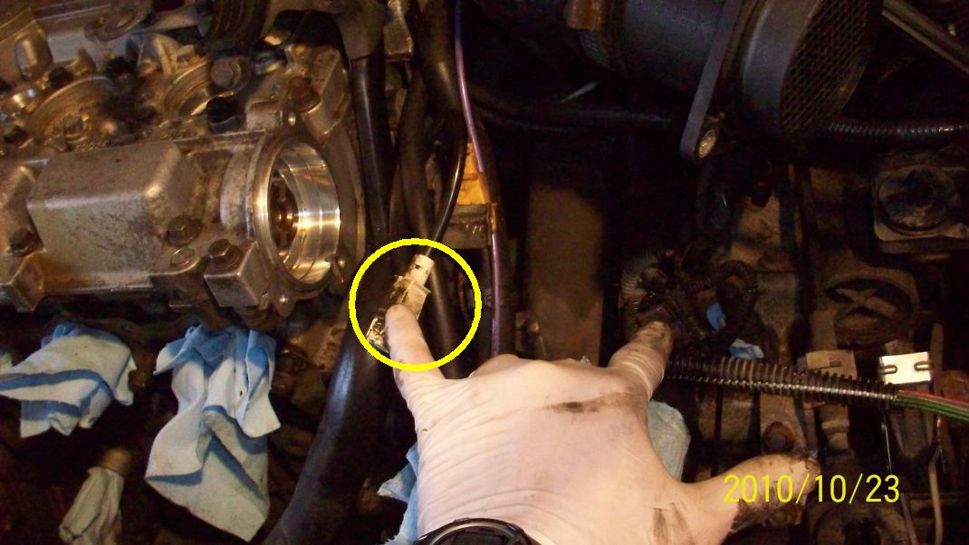

Thanks. Not exactly sure I know where it is that you are saying the BellHousing, but will have a look.\
As I recall when I was doing the PCV change, there were two electrical connections relatively close to the distributor cap... one yellow and one white (if memory servers)... are these the lines that you are suggesting that I zip tie?
Jacblackburn: you also mentioned "Don't assume it's not worn ignition components either"... with only 1000KM on my new distributor cap, rotor, wires and plugs, you think I might have to pull the distributor cap again and look inside for worn contacts? hmmmm hope I don't wear them out that quickly... will get costly replace the cap with ever 1000KM... will look...
Thank you
Thank you

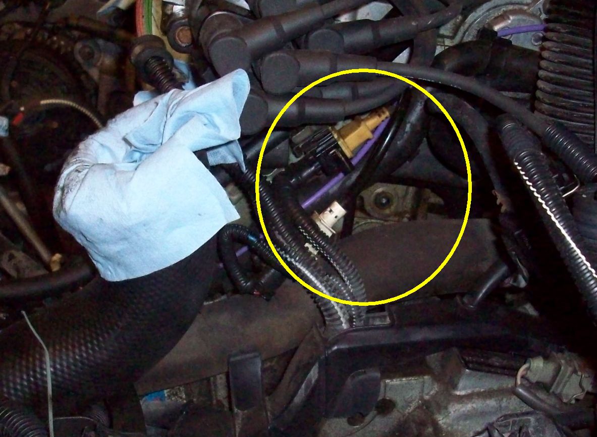

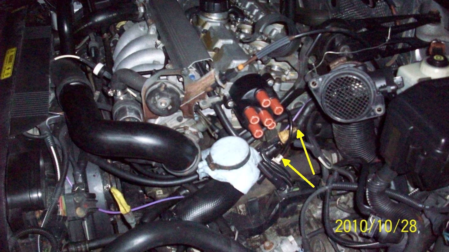

Heh, you caught me. Again, it seems. That's where I was reading too quick again. Didn't realized you'd replaced those, so ignore that
See that black insulated (not the plastic crap that falls apart) wire on the very very, right of this picture? That's your crankshaft sensor and one of the wires you want to get away from it.

Thanks again for the prompt reply.
I take it you are warning me about keeping the wire going to the white connector away from the distributor cap... as pointed out in the following pics... correct?
I hope my misfire could be that simple of a fix.... otherwise, guess it will be time to get to the crankshaft sensor itself.... the white is the crankshaft sensor line I trust? Not all great pics, but they should do the job so that we are on the same page...
Though some of these show all the dirt in the engine and on the wires, no fears, I cleaned up as best as I could while I was doing the PCV fix

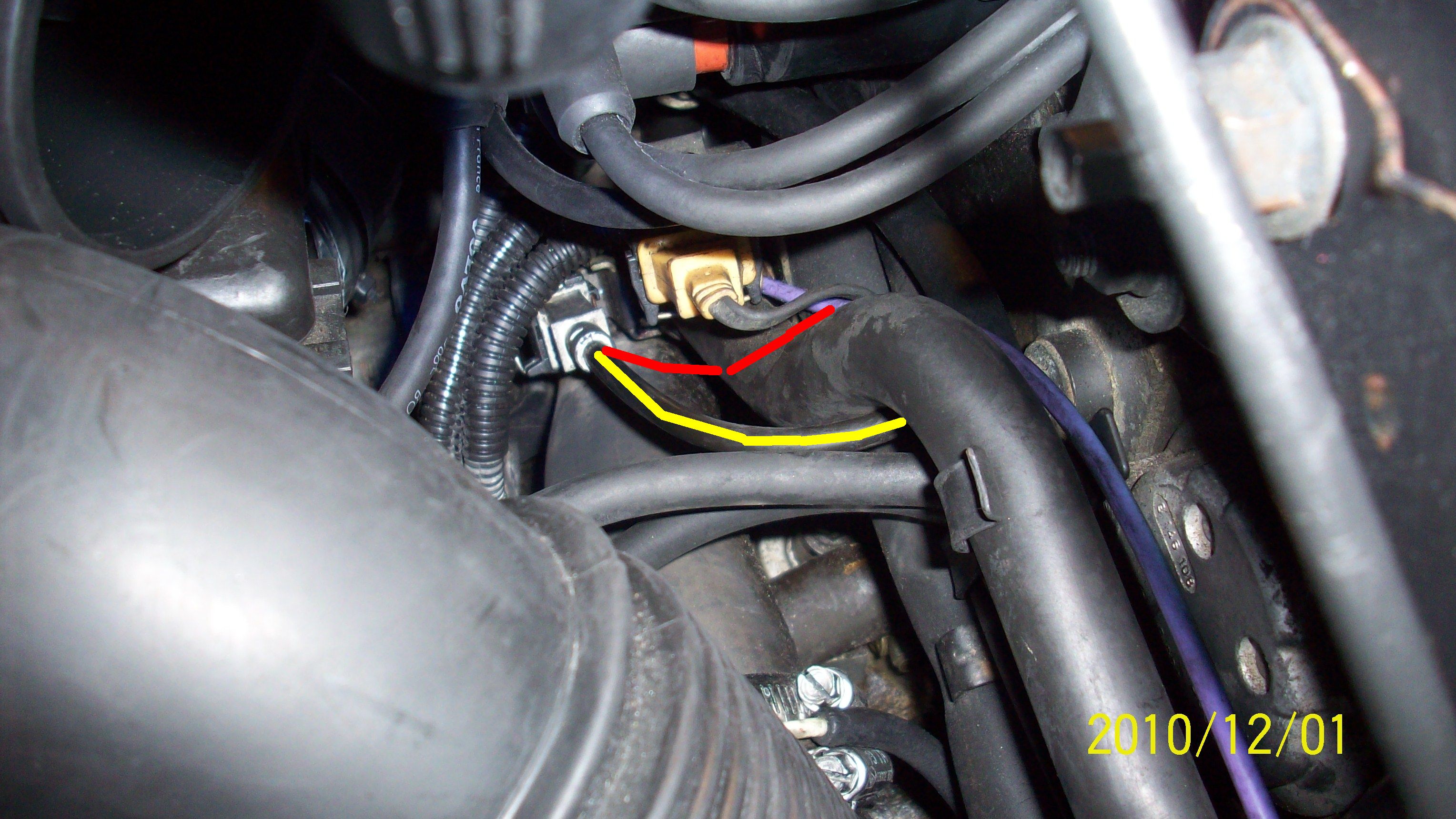

Wow… that was too nice to do..
Fix
No replacement parts
And best of all, no payment for hardware, tools or a paid mechanic.
Thank you so much for the prompt replies.
Previously I would go 10Km or so and would start to get P0300, P0302, P0304 and P0305 ODBII codes… random misifires. I must have routed the crankshaft sensor wire a different route when I did the PCV change. I simply though I was putting everything back together in the most appropriate ways/routes. Either I did this and there were issues previously or I change the route of this set of wires. Either way, my problem of getting the misfire errors on #2, #4 and #5 did not occur when I went for a 45Km test drive this evening. As best as I can recall, I used to get ODBII codes within the firsts 10Km of driving preveiously.
You guys are great. Thanks for the help
Below is a picture …Red is the route that the wire ran previously, Yellow is the route that the wire is running now and working great.
THANKS....
ps: with such great help in such short time, you can be sure that I will continue to review and post as I have questions
thanks again
