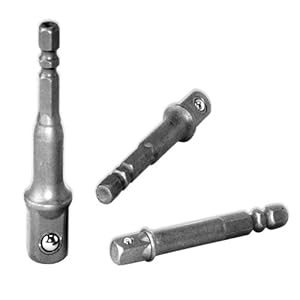

Hard part is getting it out...I managed to get an angle on the bolts by using a 1/4" wrench around something like this:
If you have a teensy tiny 1/4" ratchet that might work as well but I didn't and I don't think you would have too much room. This adapter works because the closed end of the wrench is at an angle which brings the end of the wrench closer and gives a bit of clearance. Fortunately the bolts only need to be broken loose and then they spin out... well mine at least!
