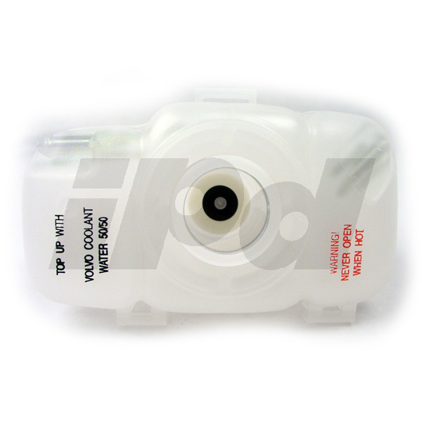

Post by JDS60R »
It should look like this

Post by JDS60R »
Here is the sensor that plugs in from the bottom

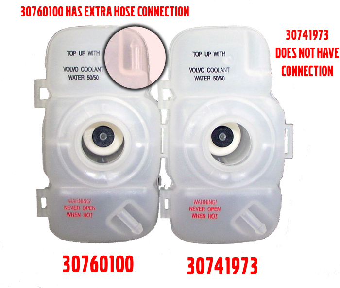

Post by JDS60R »
Both the 5 cyl and 6cyl have them . it appears some after market tanks may not. But the plug that the old one went in should still be close by
