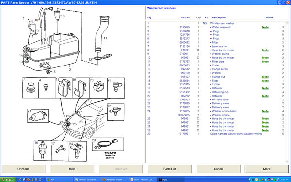

How many did you end up replacing? It sounds like pressure is still escaping somewhere. Here's the whole parts list for a V70. It looks like there's 3 multiple-way valves in the system.
