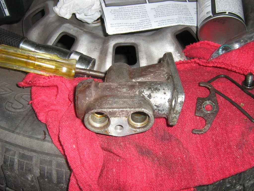

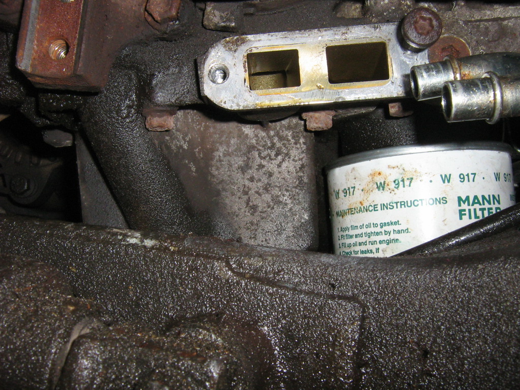

Some pictures of the oil cooler line connectors, line bracket bolt, oil thermostat, etc
- Oil cooler thermostat off the car with o rings and gasket
- IMG_2642.JPG (348.58 KiB) Viewed 12099 times

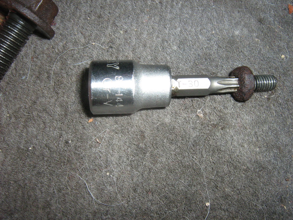

- Torx socket and bolt from thermostat
- IMG_2645.JPG (452.48 KiB) Viewed 12099 times

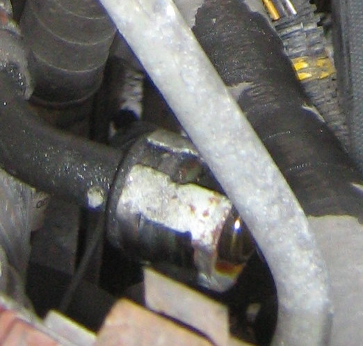

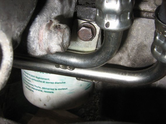

- Oil cooler line bracket- note AC compressor bolt that partially blocks it.
- v70 oil cooler hose bracket small.jpg (45.37 KiB) Viewed 12098 times

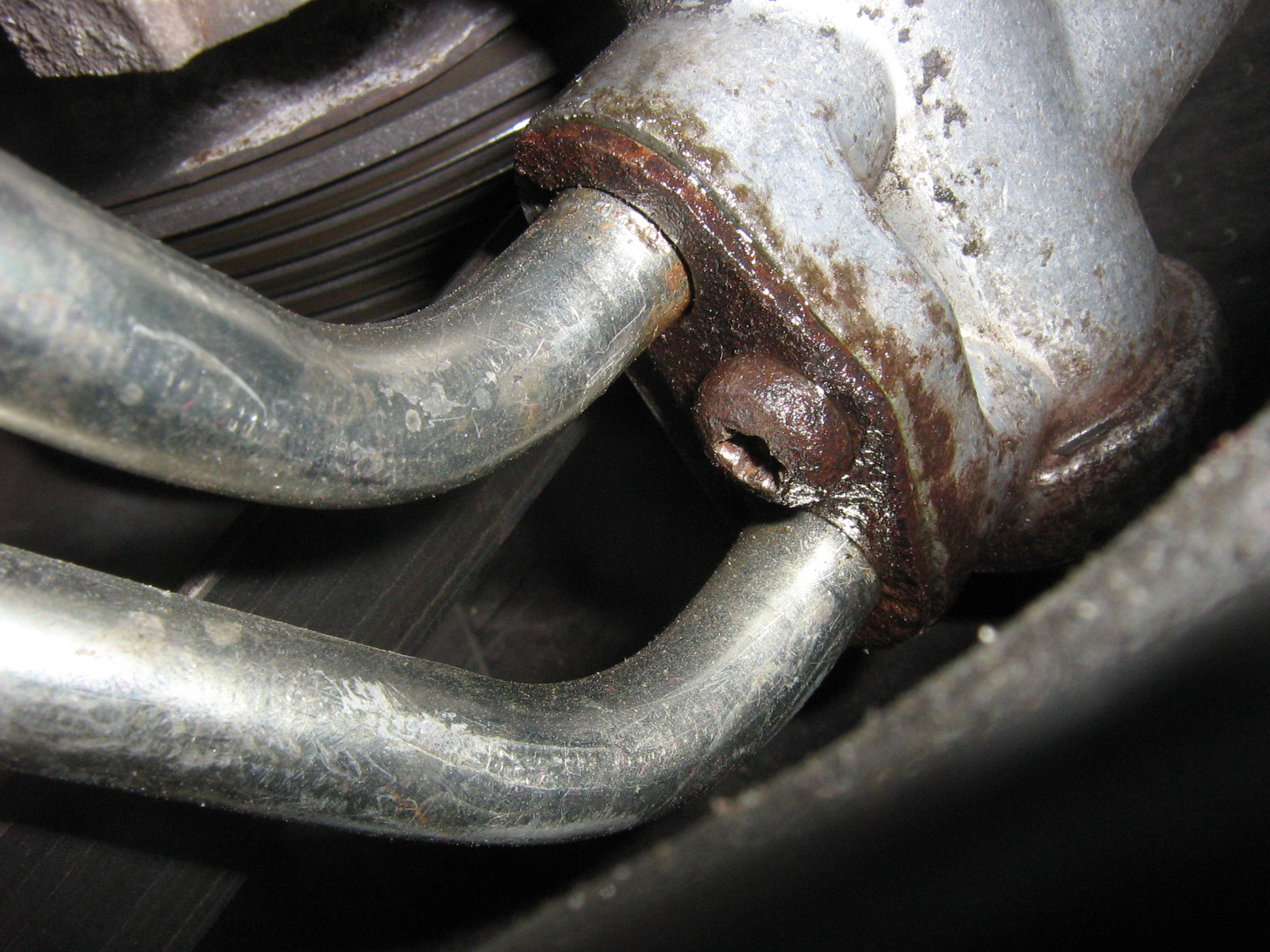

- Oil thermostat showing where lines and o rings go in.
- oil thermostat.jpg (214.09 KiB) Viewed 12099 times

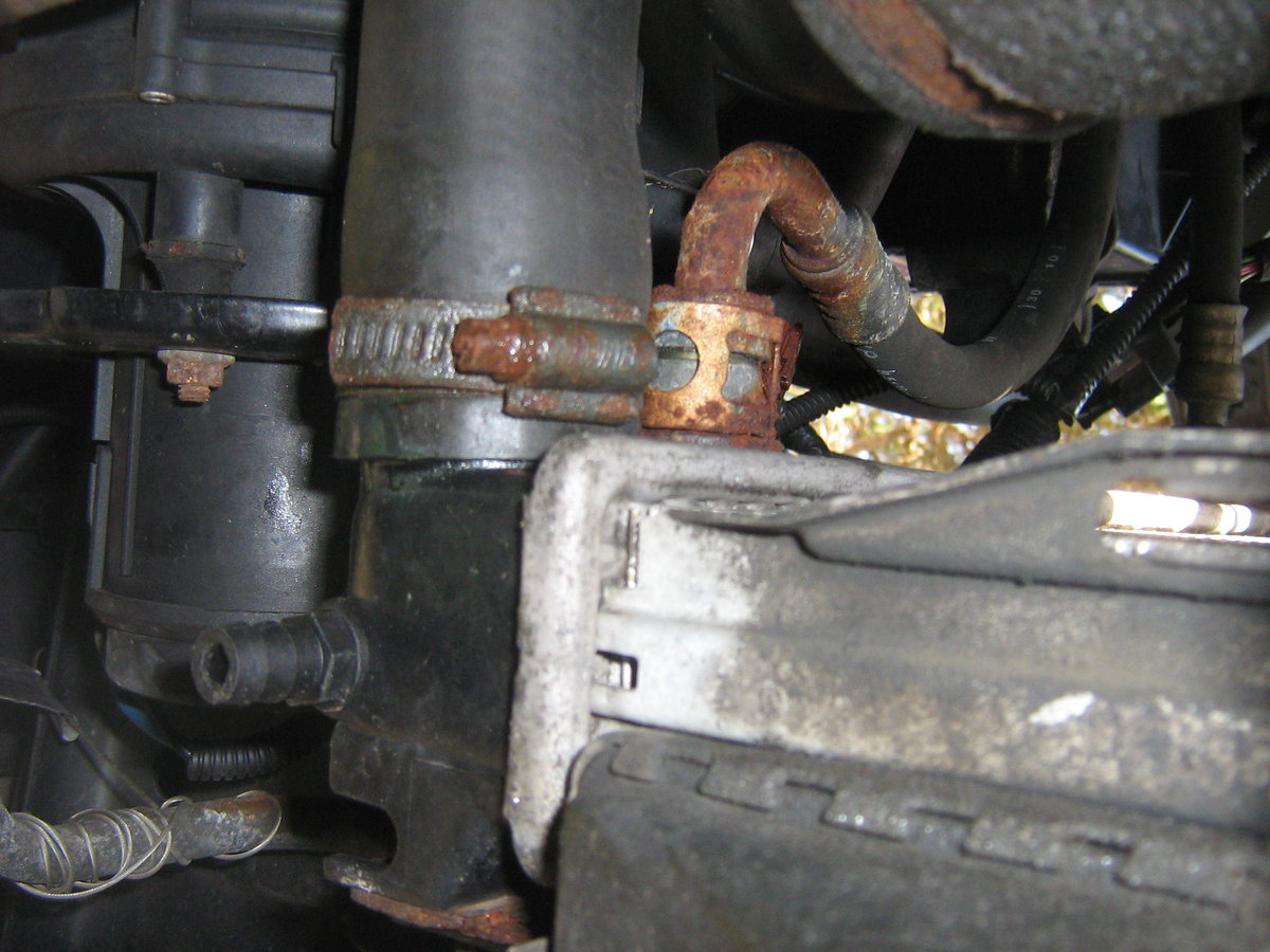

- New oil cooler line at radiator
- IMG_2662.JPG (136.18 KiB) Viewed 12099 times
- This is the nasty bolt that holds the oil cooler line bracket to the engine. Note the interfering AC compressor bolt. With the bracket on, the only way I could get a socket on the bolt is to go across the subframe with a long extension.
- Img_2237.jpg (185.4 KiB) Viewed 12099 times
- Shot at the end of one of the oil cooler hoses showing the clamp. Gently pry open the clamp and pull the line away from the rad.
- oil cooler hose old.jpg (68.62 KiB) Viewed 12098 times
