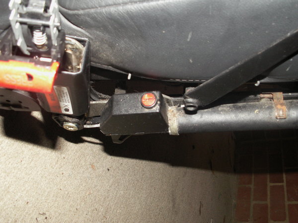

I have a 95 850 SE. The buckle for the front passenger seat belt has broken. I have a new buckle to replace the broken one. I removed the seat from the car to make it easier to do the job and was confronted by a sticker that said I could lose a finger trying to remove the seat belt stalk! There is a steel cable running from the bottom of the belt buckle into a black box that is mounted on the side of the seat base just in front of the buckle. There is a long cylinder running forward from the black box. The black box has a small red button with an arrow on it on the top. I appreciate that this is part of the pretensioner setup for the seat belt.
How do I isolate the pretensioner so that I can remove the buckle and put the new on without setting it off and losing a finger?

Hiya, thanks for the feedback but I think we are talking about different ends of the seat belt. My issue is with the buckle end that the tongue on the seat belt plugs into. I haven't touched the reel that is mounted in the B pillar and its associated pretensioner and I don't intend to as part of this job
. I have the seat out of the car so there are no wires connected to anything anywhere.
I have taken photos of the seat belt stalk and the offending pieces.

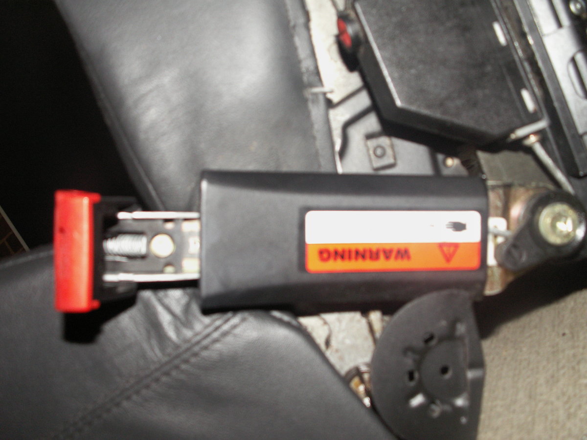

This is the busted buckle/stalk that needs to be replaced. This is the pretensioning mechanism that I am concerned about. The red button on the top of the box with the arrow on it can be pushed down and turned 90 degrees so that the arrow is pointing sideways.

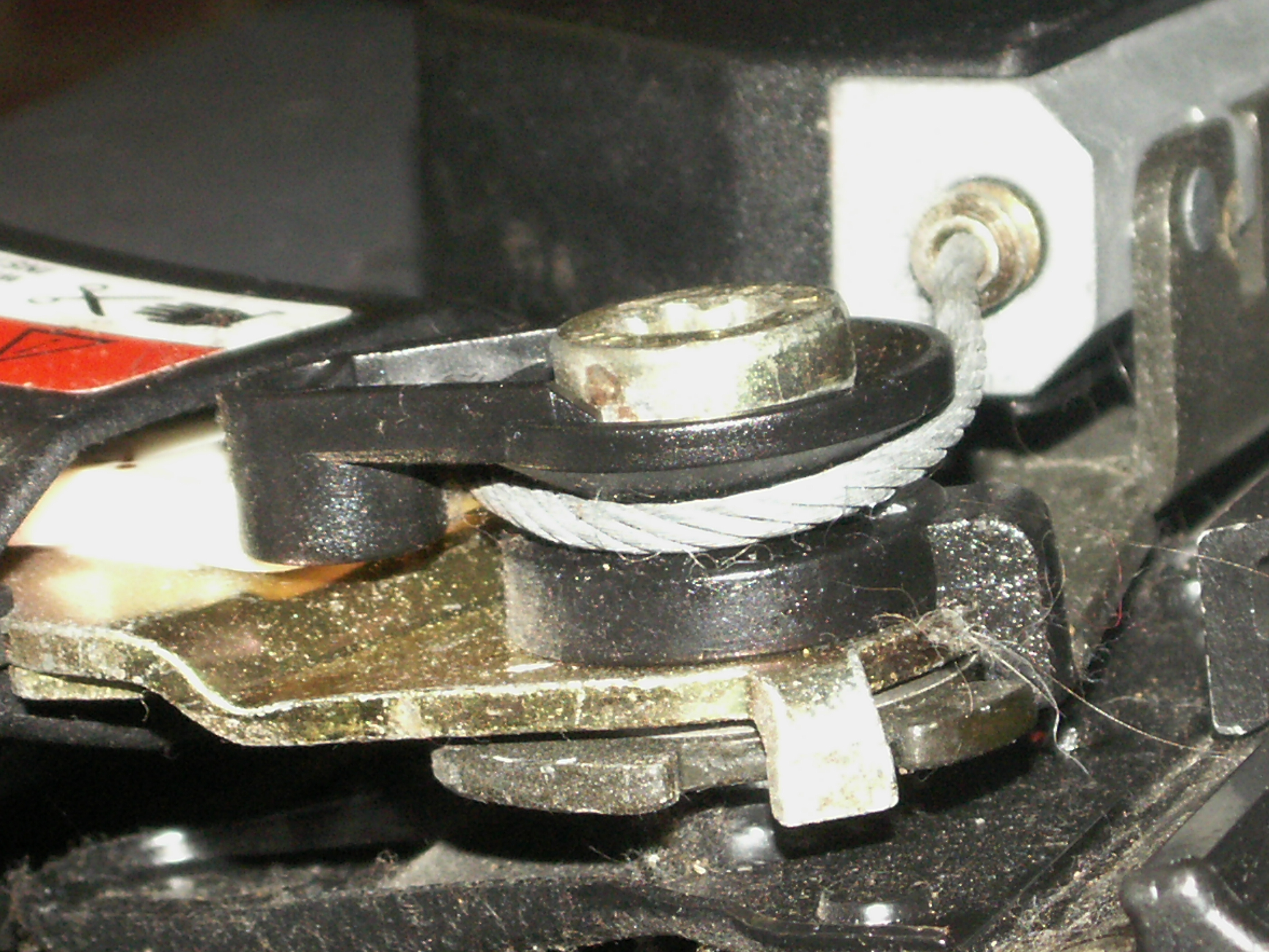

This is the bolt that secures that seat belt stalk to the frame of the seat and shows the steel cable that runs into the stalk from what looks like the pretensioning mechanism.

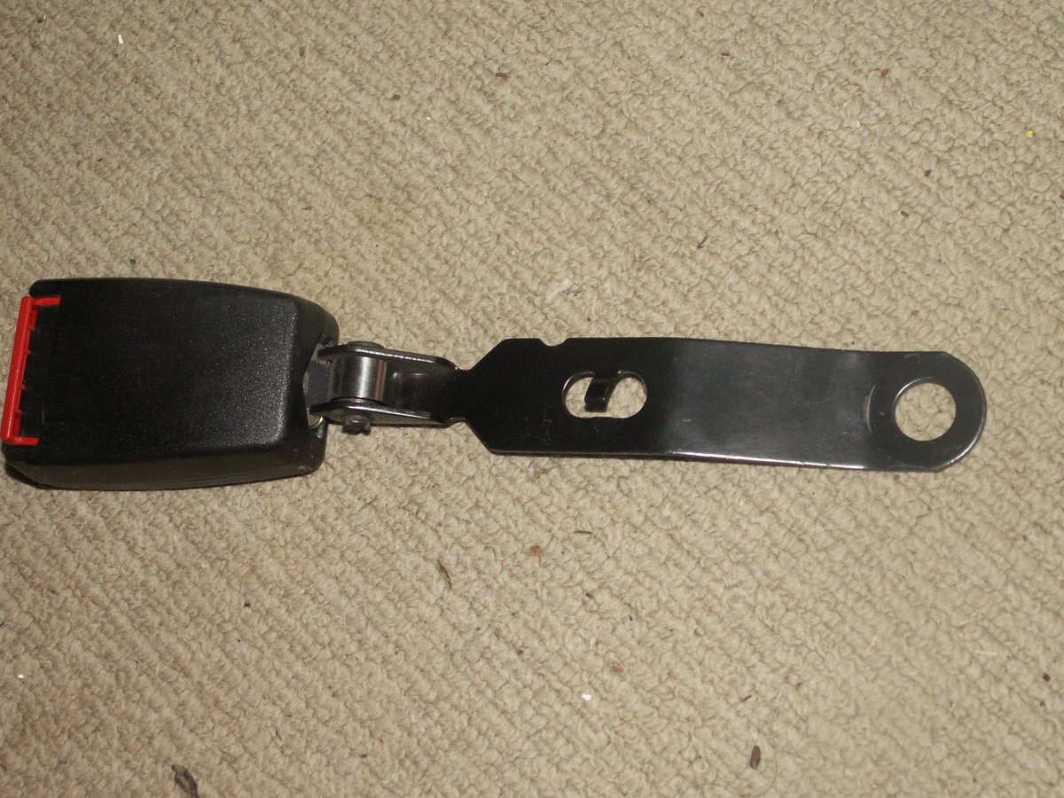

This is the new buckle to go in. Thoughts? suggestions?
