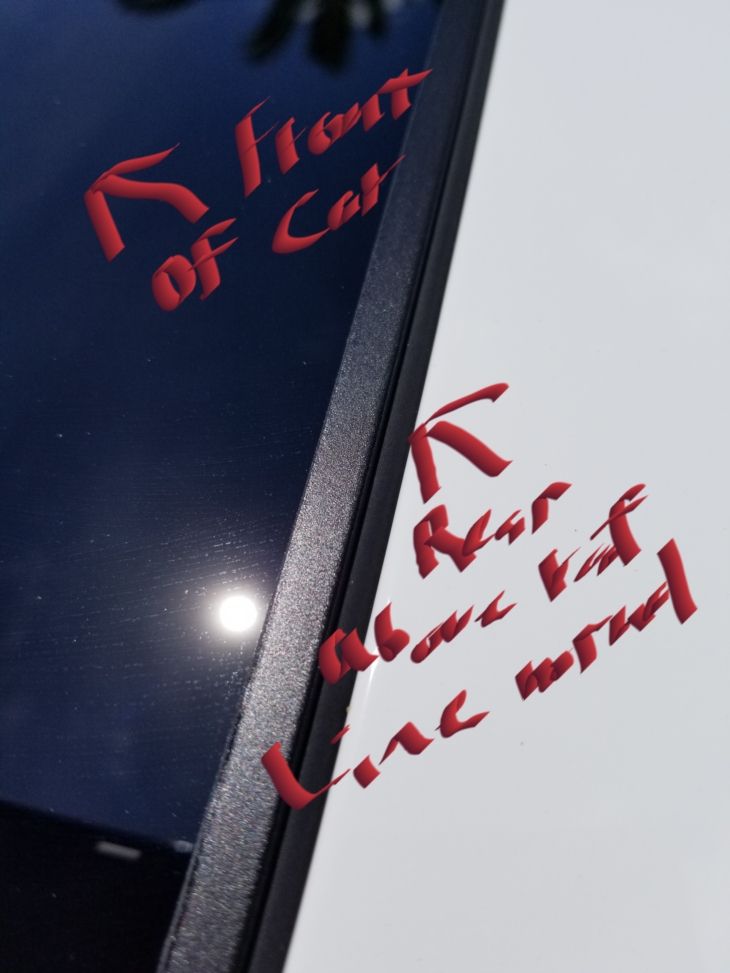

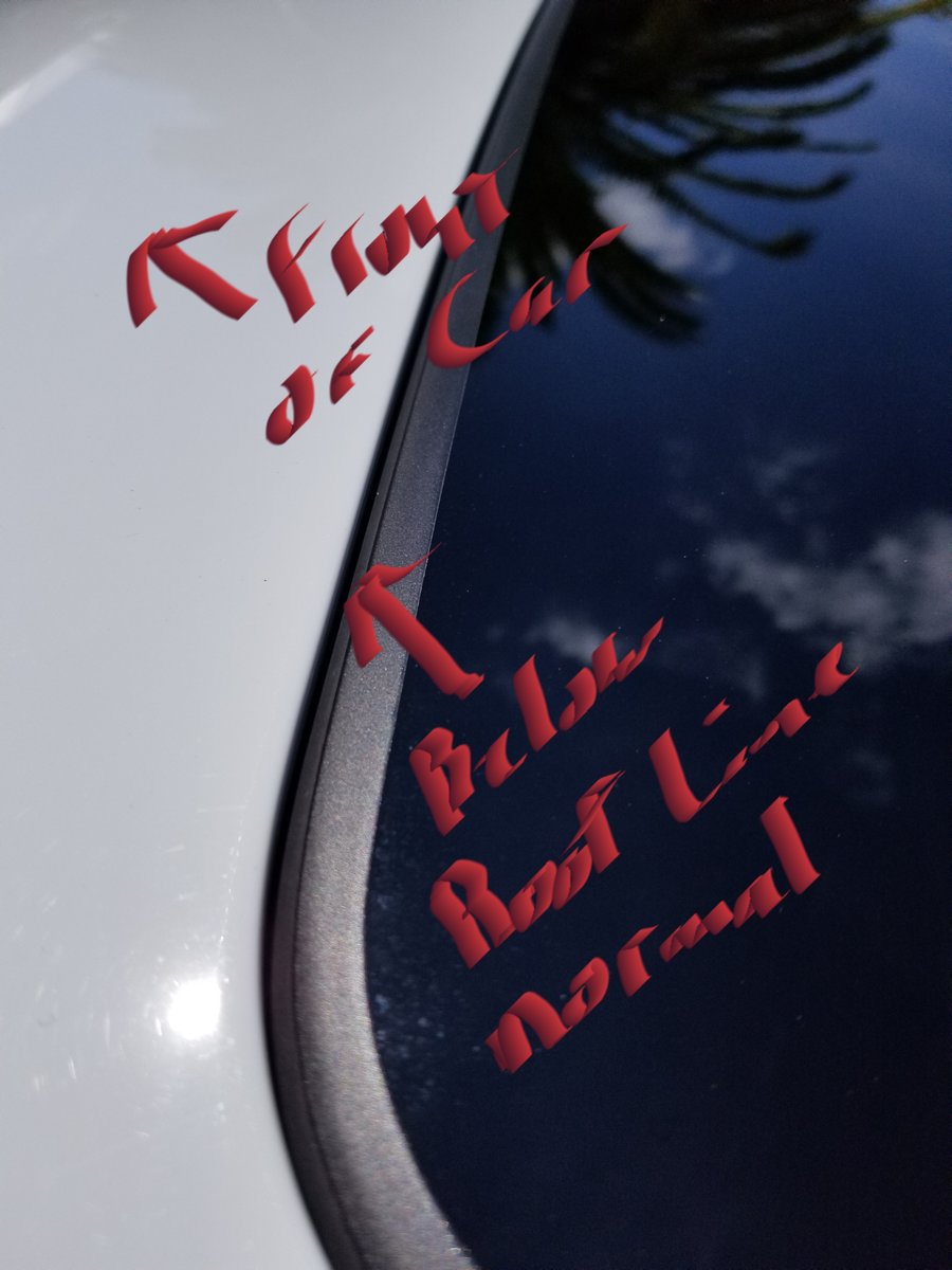

Glass in closed position the front of glass is below roof and at rear of glass above body is normal. My moonroof in the last several cars came from the factory this way and the answer from Volvo is it is positioned this way to prevent wind noise. June

On mine the back is at the roof line, but the front is above. So the exact opposite of how it should be I guess.
