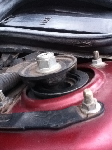

So next on my list of things to repair on on my are the brakes (rotors are warped in front) and the front suspension.
When driving, the front suspension (specifically front left) is very noisy. It squeaks when coasting (more noticeable at low speeds) and makes bumps and rattles at highway speeds. Potholes feel extremely hard. As you can see in the picture below, something ain't right with the suspension. I've been reading as much as I can here to try and diagnose the problem and have determined that I most likely need new struts. What I need is a diagram of the suspension and/or a suspension rebuild tutorial (I'm not getting any luck with the search with the latter)

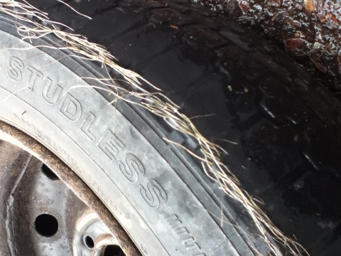

Also, possibly a related suspension problem is my back right wheel went flat. It was rubbing on something. and the metal wires in the tire became exposed. This happened when temps got down to 0 and was very cold and icy (month ago).

your upper spring seat is completely ruptured! Also there should be about 1/2 - 3/4 in of thread showing above that strut nut! Please don't drive that thing until you fix that! It's dangerous for you and others and you're gonna ruin just about everything connected to that wheel.
you can do everything yourself if you have the proper tools and you know how to use them. (spring compressors, jack, stands, etc) I don't know what your budget is but i would be looking to replace just about everything in the wheel well on both sides.

I agree; it sounds like your car is in desperate need of almost a complete suspension rebuild. With one side of the car jacked up, check for play in the front wheels from 3-9 and 12-6 o clock.\
Once you replace everything, remember to have a 4-wheel alignment done on the car or your tires will continue to wear out like that.

Had the same thing happen on my rear wheel. Simple and inexpensive visit to Autozone and had it fixed in 30-minutes. You can do the shock stuff pretty easily if all you have to do is replace that top piece.
