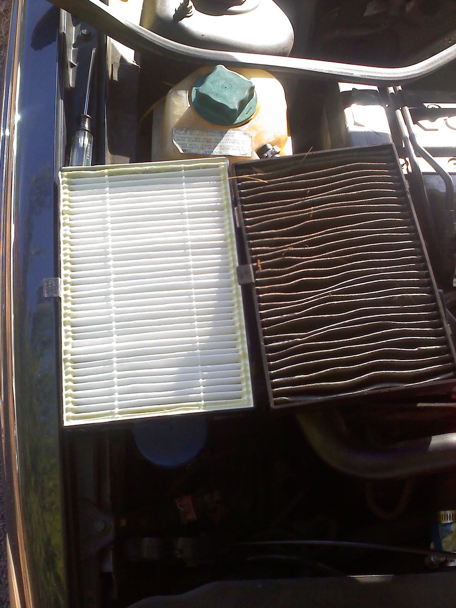

alldatadiy.com says every 15,000 miles. I changed mine last week (99 v70 glt), and almost threw up. It had been 75,000 miles since the last replacement. Something, I will change more often, its inexpensive and takes about 2 minutes

I checked mine to last night.... I ordered a new one but i wanted to see what it looks like because its been at least 60000kms since it was last done... It was dirty and had some fluff in it... but I vaccuumed it out really well for the time being.

If its dirty, the air flow will be restricted. But the dirt (pollen, dust etc) will still not get through the filter. So good idea to change it but don't worry too much about breathing what is stuck on the other side of the filter.

The dirtier the filter, the better it works technically. The flow won't be as good, but it's "cleaner".
