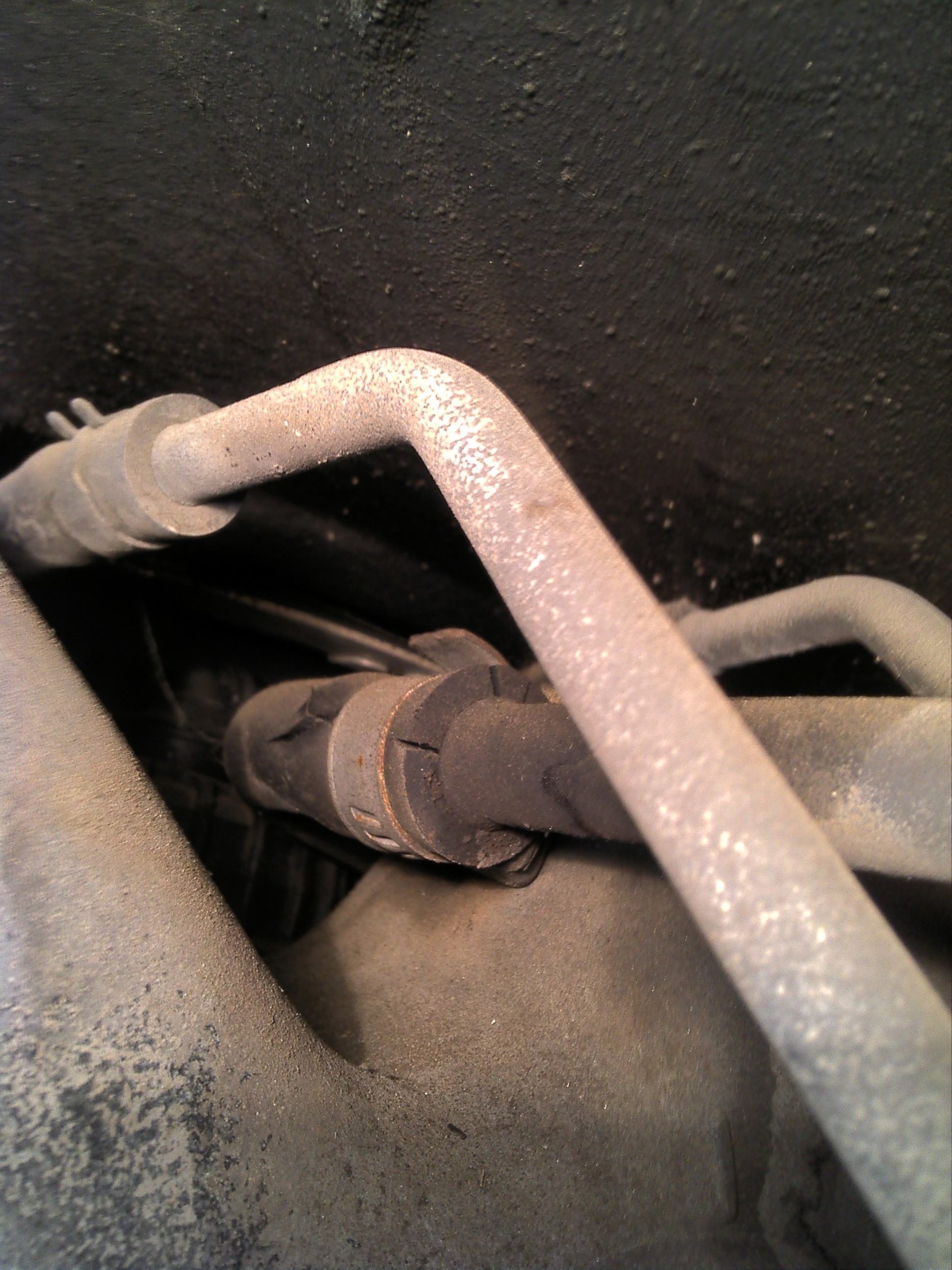

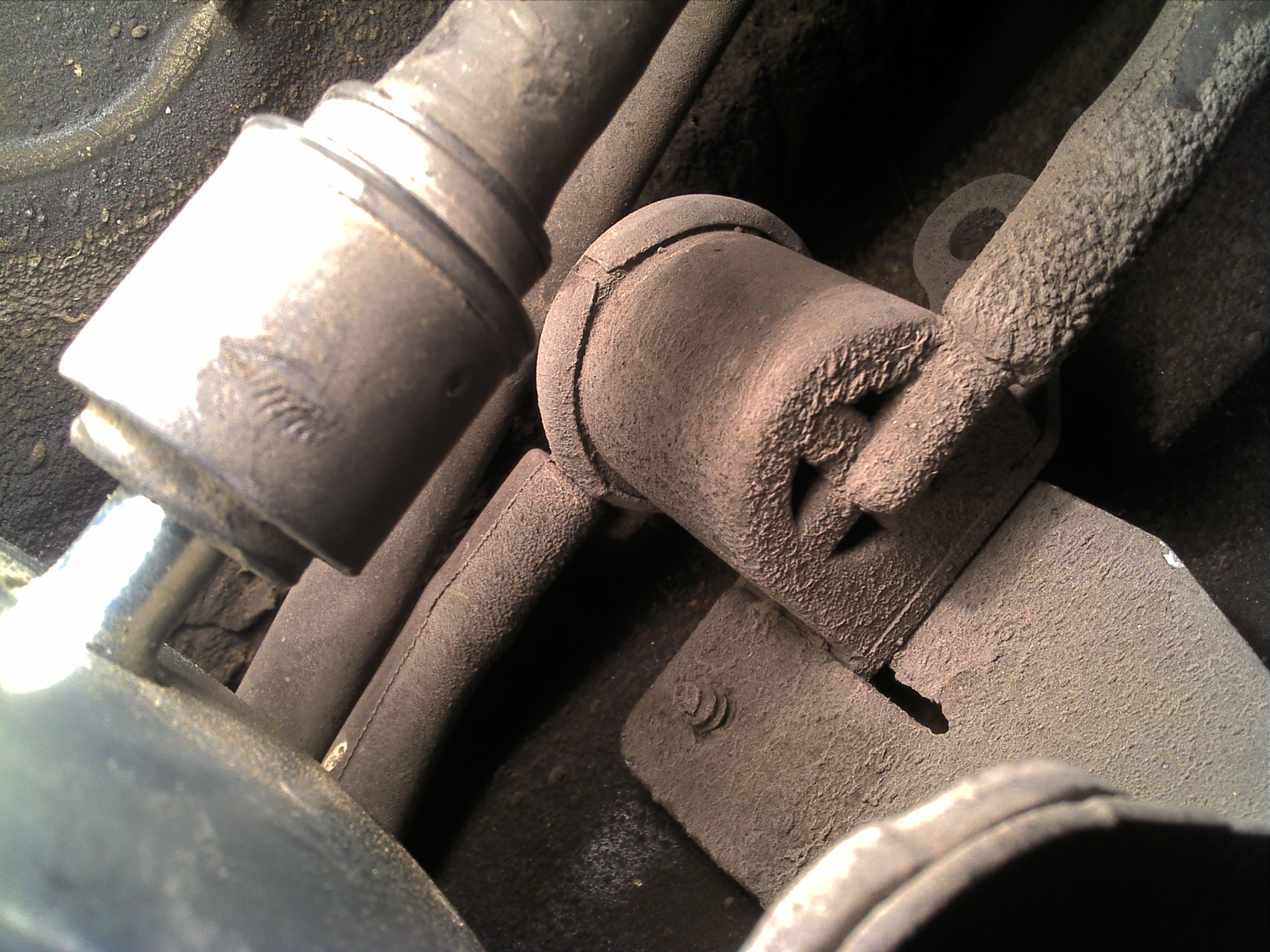

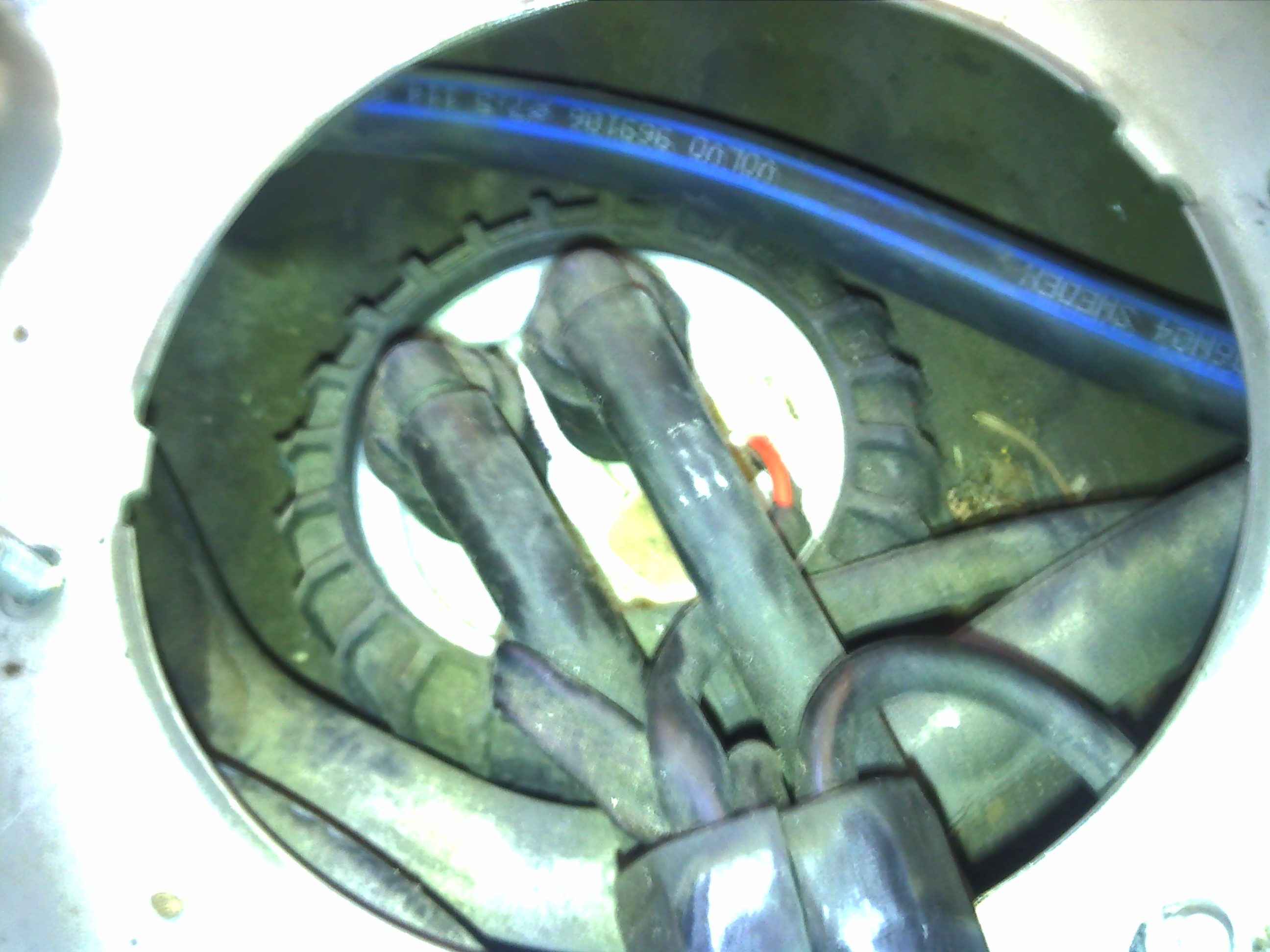

I found the issue. Like jblackburn said, I found the cracked hose on the fuel tank.
Sorry the pictures are not so clear. My dell phone doesn't take very good pictures. So now, if I had alien fingers and arms then I can probably squeeze around that tight area and replace the hose but I couldn't even get my hand in there to feel the hose. Does this mean I have to drop the fuel tank to work on it? or at least lower it a little bit to replace the hose?
Is there a easy way to do it? Does autozone carry hose like that? does anyone know what size that is? I think I want to get the hose first then replace it. I dont want to leave this unplugged and go to autozone to match hose size. You know what I mean.
