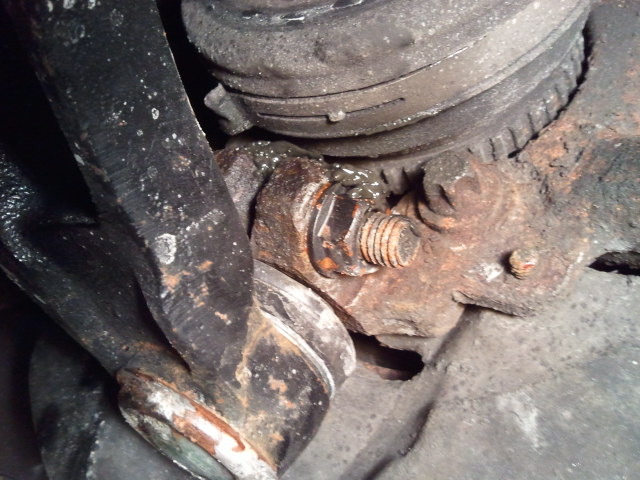

+1 on cleaning the sensor pickups:
This is pic of the front pickups, right above the ball joint. It's harder to get at compared to the rears, but it takes a few minutes to pull the wheel and brush 'em with an old toothbrush.
