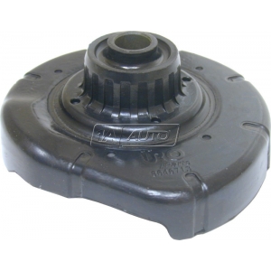

My strut seat springs wore out...could be the problem?
- could be this ?
- mount.JPG (46.66 KiB) Viewed 13240 times

"Are you feeling the bumps or hearing the bumps? " Its definitely ride firmness. No noise and top spring seats don't spin. Its just gotten at worse in the last couple of months. I know its no caddy and it never was, but it was better than this. My whole dash jumps around cause of the bumps and how bad they hit.
So I'm thinking do struts, spring seats (will these work?? they are aftermarket though http://www.fcpgroton.com/product-exec/p ... ory_id/185 ) and strut mounts. Thoses are two separate things... As far as the rear is concerned, is there a bushing or mount like the one in this link ever need to be done? Comparing bump hits the front is not as bad as the rear, rear hits hard. Best way I can describe it.
