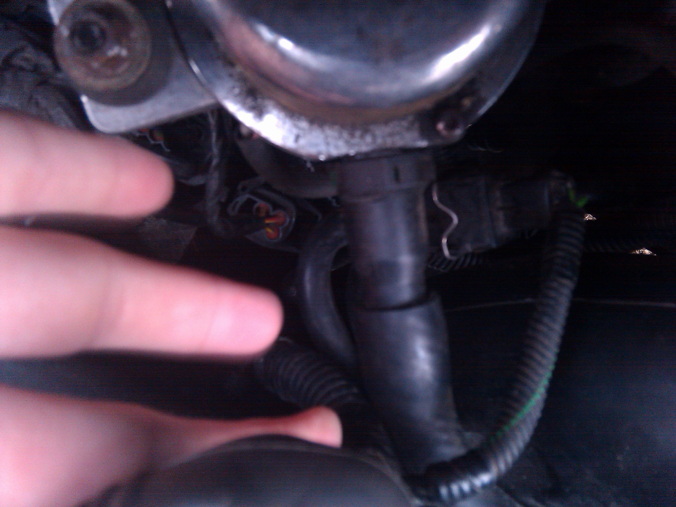

This is the part I'm looking for, I'm unsure what the part number is. VADIS did not have it nor did ErieVovo.
